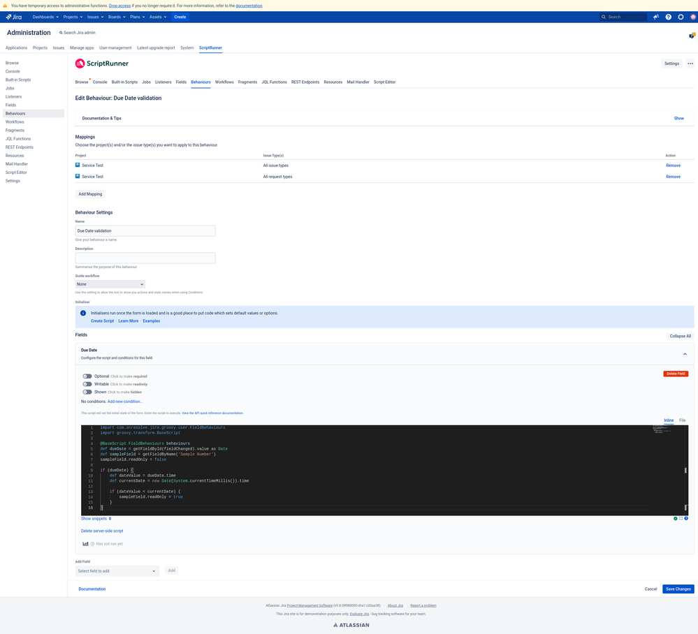

Below is the fully working Server-Side Behaviour code for your reference:-
import com.onresolve.jira.groovy.user.FieldBehaviours
import groovy.transform.BaseScript
@BaseScript FieldBehaviours behaviours
def dueDate = getFieldById(fieldChanged).value as Date
def sampleField = getFieldByName('Sample Number')
sampleField.readOnly = false
if (dueDate) {
def dateValue = dueDate.time
def currentDate = new Date(System.currentTimeMillis()).time
if (dateValue < currentDate) {
sampleField.readOnly = true
Please note that the sample working code above is not 100% exact to your environment. Hence, you will need to make the required modifications.
Below is a screenshot of the Behaviour configuration:-
I am also including a couple of test screenshots for your reference:-

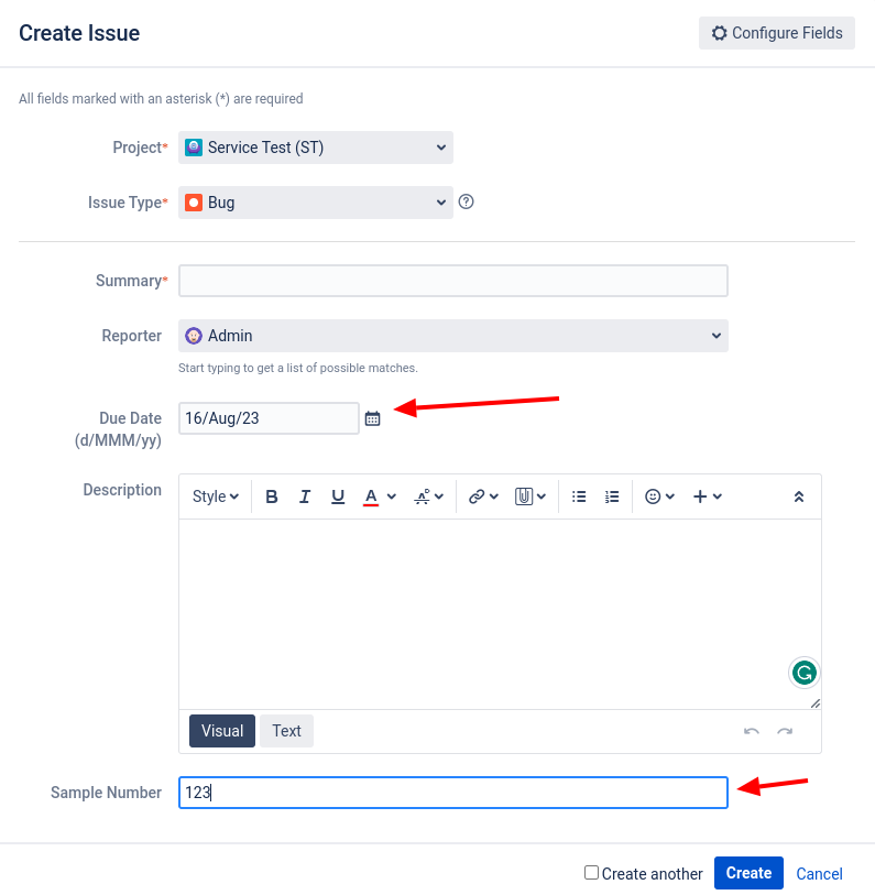

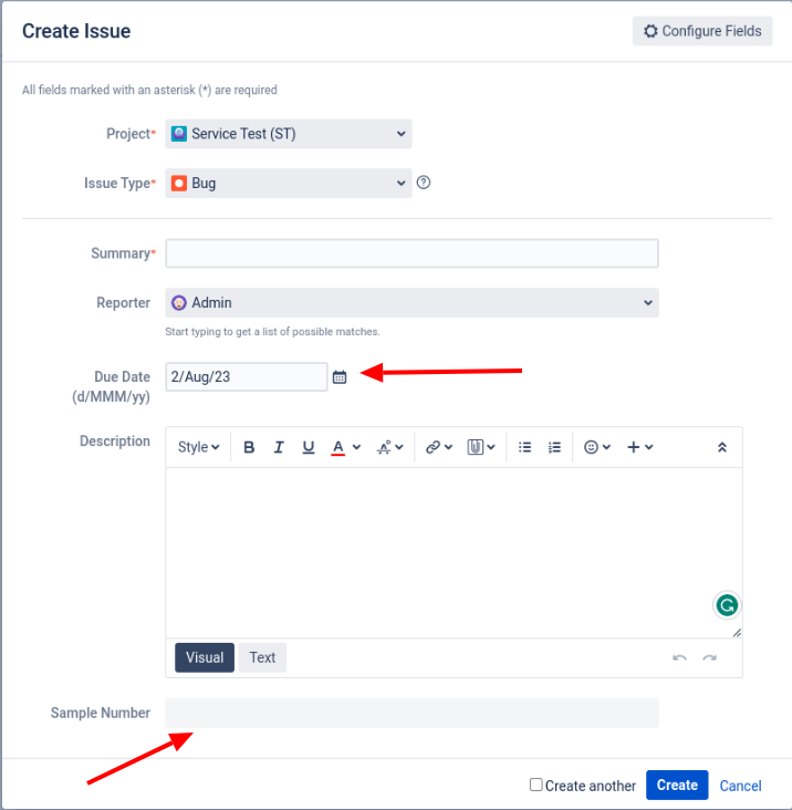

1. When the issue is being created, if the value set for the Due Date is before the current date, the Sample Number field will not be editable as shown in the screenshot below:-
2. If the Due Date field is later than the current date, the Sample Number field is editable as shown in the screenshot below:-
