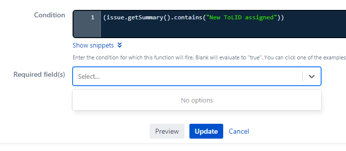

2. I tried to use the ScriptRunner Validator field required in the workflow, but when i get to the select field option it has no option see screenshot below, even those there are a bunch of custiom fields configured on the data center server. On the other hand, i can see the custome fields when using conditions, but when set it makes the transition button disappear. Please advise. Many Thanks in Advance

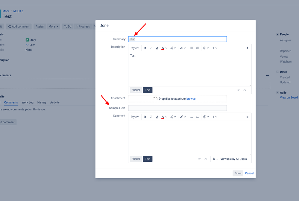

Below are a few test print screens for your reference:-
1) The summary currently is just Test
2) When the issue transition's to Done, the Sample Field is not set to mandatory.

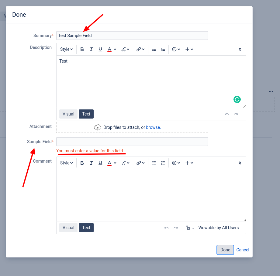

3) Once the field name, i.e. Sample Field, is included, the Sample Field text field is mandatory.
4) Now, if you try to click on the Done button without entering any values into the Sample Field, an Error message is returned, as displayed below.
