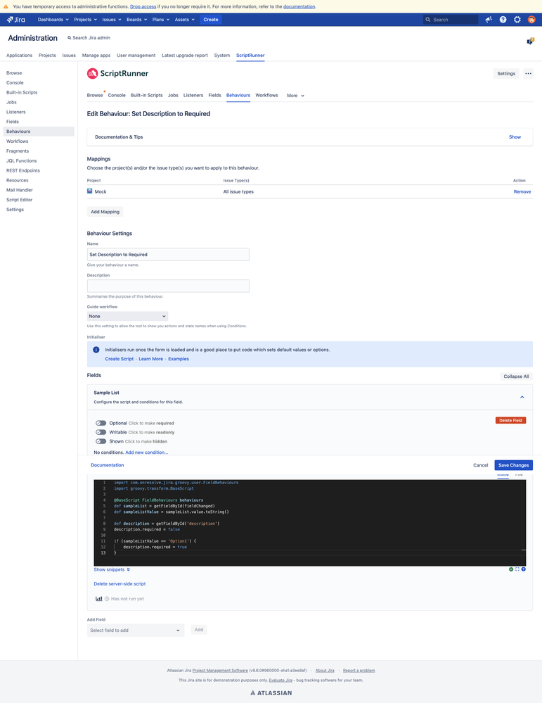

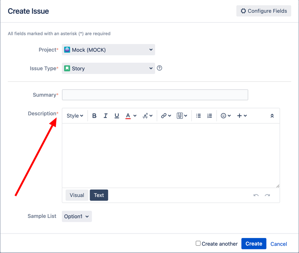

Below is a screenshot of the Server-Side Behaviour configuration:-
I am also including a couple of test screenshots for your reference:-

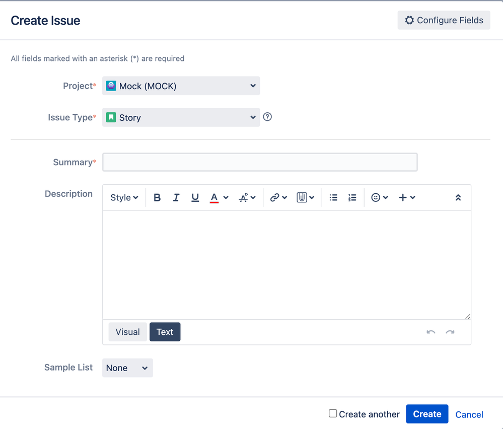

1. When the Create dialog first loads and no option has been selected from the Single-Select List as expected, the Description field is not set to mandatory as shown in the screenshot below:-
2. If Option1 is selected from the Single-Select List, as expected, the Description field is set to required as shown in the screenshot below:-

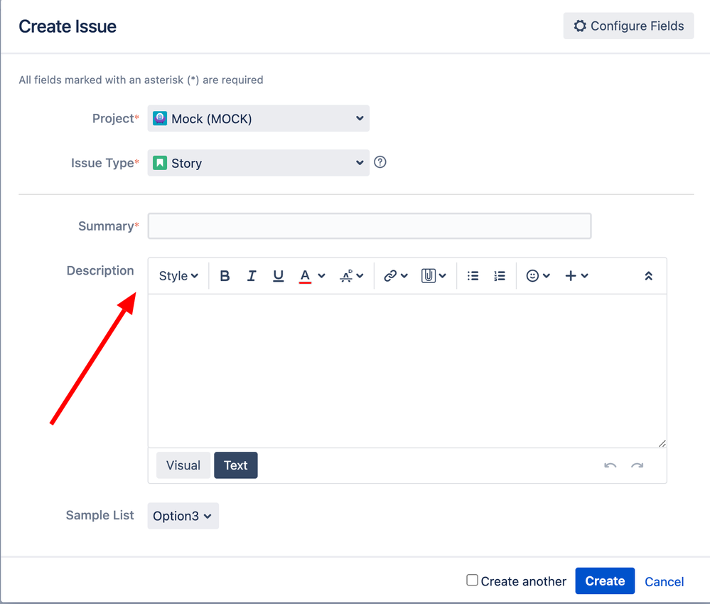

3. If any other option aside from Option1 is selected, the Description field will not be set to required as shown in the screenshots below:-
I hope this helps to solve your question. :-)

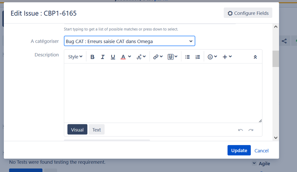

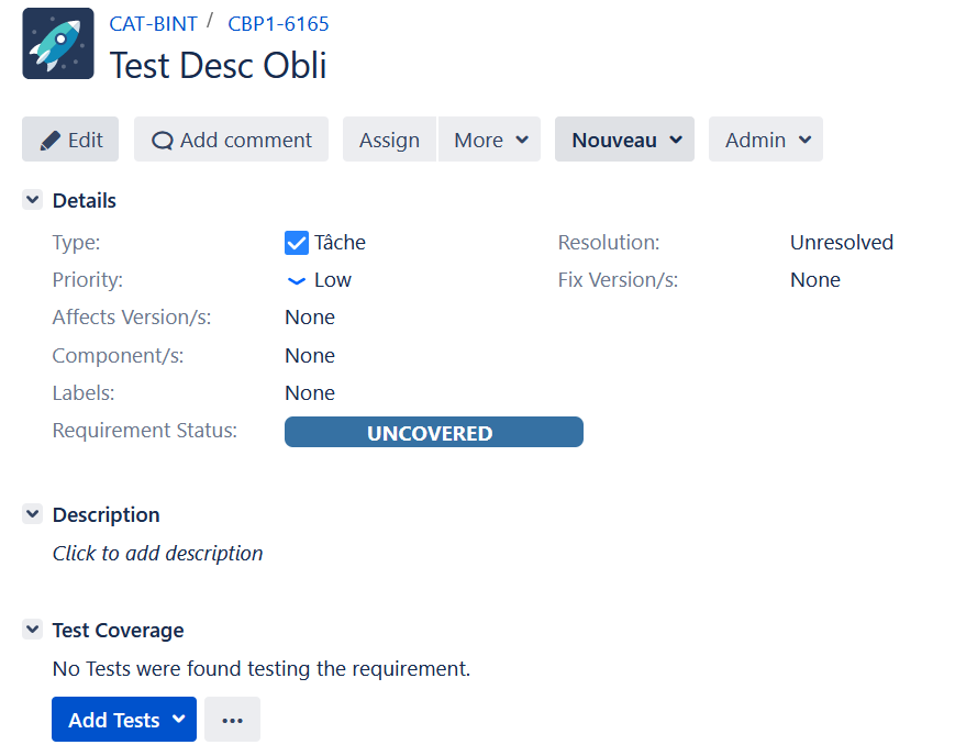

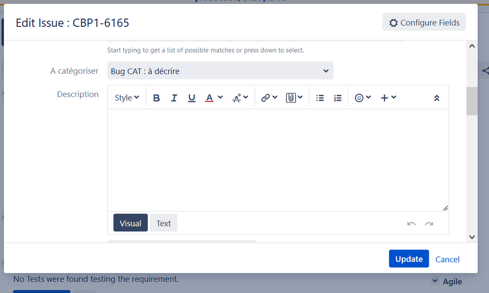

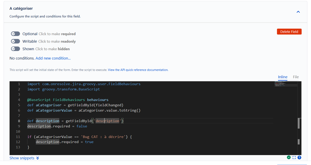

Ulrich Kone
November 20, 2023
Hello @Ram Kumar Aravindakshan _Adaptavist_
Thanks for your asnwer and sorry for the delay
I tried the solution but it seems to not work
Maybe I forgot something
I am inclunding the screenshots
Ulrich Kone
November 20, 2023
Ulrich Kone
November 21, 2023
Thank you very much
It works properly (I had a quote in my custom field Value)
