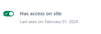

The managed account still have access as follows:
Has access on this site YES
Jira Software NO
Confluence NO
Confluence GUEST NO
and it does have admin rights for the project we want it to manage.

Project permissions don't help if the user in question has no license assigned.
No license is "No Access".

If I understood correctly, you are saying that this "Has access on site" is not sufficient and I need to turn on the one for Jira so that the managed account has access to Jira as well?
Because as mentioned the configuration for this managed account remained the same for 2-3 years, it was just suddenly not working after 8 Jan 2024.
Is there any changes on Jira side that causing this to happens? (if you happen to know)
Has access on site only means the user would have access to an open JSM portal or anonymous accessible Confluence spaces is there are any.
The user wouldn't have access to a Jira project if not granted a Jira license and therefore wouldn't be able to provide any information from gitlab to a Jira issue.

I have just enabled the Jira Software access then voila the api token start working again. Im not really sure whether there was any changes on Jira site prior to this, as it was working before.
