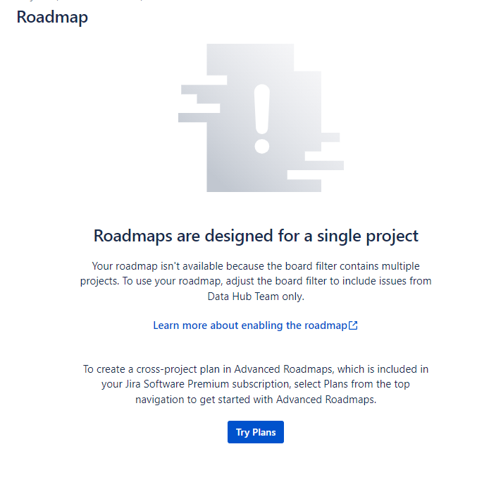

I need a functioning Roadmap for each of them so I went to 'board settings' and enabled this for each. The filter query is set for each board, for example, the 'Data Governance' board, is under the Data Hub Project, with the filter query 'project = DG ORDERED Rank ASC'. This should technically allow me to go under roadmap and create the epis I want, right? That's not the case as this is what I see when I go under Rodmap:

You cut off your original screen shot above without showing the actual filter query. Can you take another screenshot to include what shows under Filter Query?

the base filter for all the boards in your project should be
project = “Data Hub Team” ORDER BY RANK ASC
however as also referred to before as you are using team based projects I would highly recommend making a different project for each of these teams and using just a base JQL like the above for each board you make thereafter
looking at your filter project = DG ORDERED Rank ASC'
that filter says you are trying to reference a project not the board. Boards themselves aren’t projects
if your single project is going to to have 3 teams work in it (though you’re using team based projects, so I would actually advise against this, team based projects whole idea is each team has their own project. In agile a team is a working group, so the members of a given board. Teams are the small 3-5,usually, working groups for the project. If you want multiple agile teams working in one project classic projects are better) then you would want to use a board filter that identifies the same project on all 3 and then also has a unique identifier like a custom field or a component
project = “Data Hub Team” AND component = “x” ORDER BY RANK ASC
