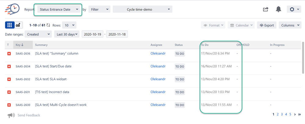

As an alternative, you can try the add-on developed by my SaaSJet team - Time in Status for Jira Cloud.
This add-on measures time spent in each status. It also has the Status Entrance Date report, which shows the date and time when every issue has entered each of the statuses for the first time.
And Status Count report, which calculates how many times an issue has been in each status. So you can track each issues' movements and how many times it has occurred.
If you need to get data not only a particular Assignee but the whole project, just choose necessary filtering: by Assignee or by Project)
