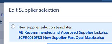

When using the Message field (for edit) custom field the message appears correctly on the issue transition screen:

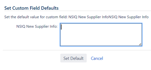

However when I went back to edit the default value the contents are no longer there.

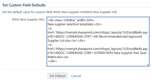

I went back and re-entered the default value as follows:
I clicked "Set default". Then immediately clicked "Edit default value" again and the field was blank. Altho on the transition pop-up screen the value is still showing correctly.

FYI - this is a bug that makes the default field for message fields with more than one project look blank, even though there is saved content. If this issue is affecting you please vote on the bug report linked below:
