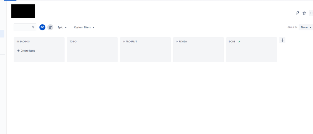

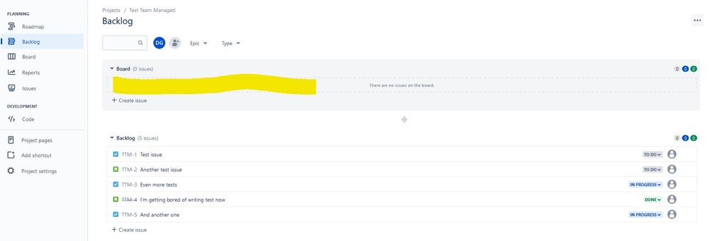

Second question is for the issues that went over, I don't see them on the board. When I go to configure board, I see this:
On the board I get this:
Not sure how I get them to show up?

As for the statuses, I'm not sure what I'm doing wrong. I created two statuses that were missing from the new project and mapped all the statuses in the old project to the ones in the new project during the bulk move. As you can see it shows in the board config pic that there are issues matching the statuses I mapped. But I don't know how to get them to appear on the board. I see the issues mapped to the correct status.
Do you have Scrum features enabled?
Have a look in your Backlog view - your issues may be in the Backlog in the right statuses and will need to be moved up to the Board section to show on your board

Can you show what options you do have on the left hand menu? Maybe try enabling your backlog: Project Settings/Features/Backlog
