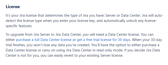

Florian Bonniec
April 17, 2023
Hi @Maahshid Vaziri
https://confluence.atlassian.com/adminjiraserver/upgrade-from-jira-server-to-jira-data-center-993929572.html
Application license and all app licenses have to use DC license. You can try in a test env to replace all your license with DC license (trial) if you want to be sure.
At some point I recommand to set up a cluster to benefits all Data Center feature.
