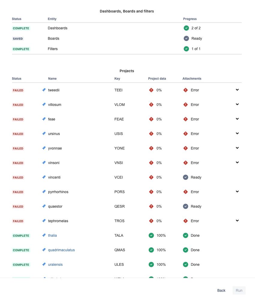

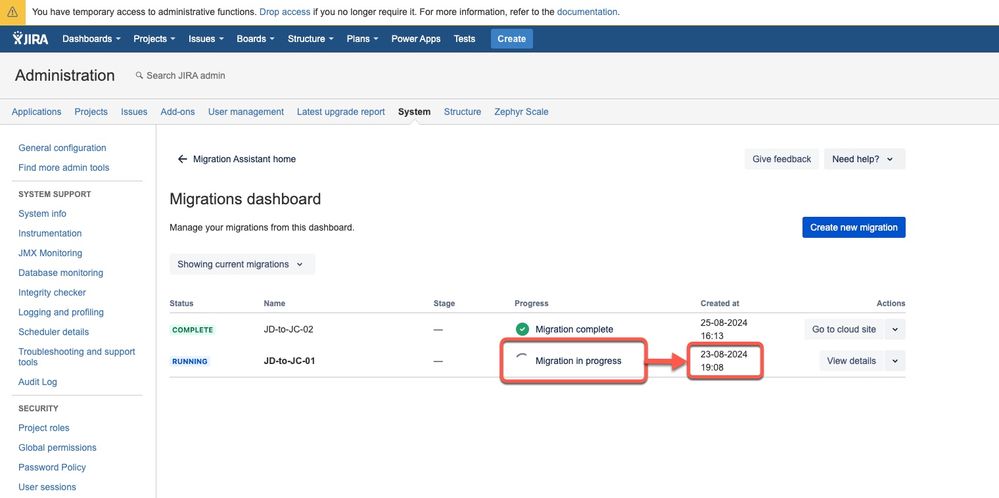

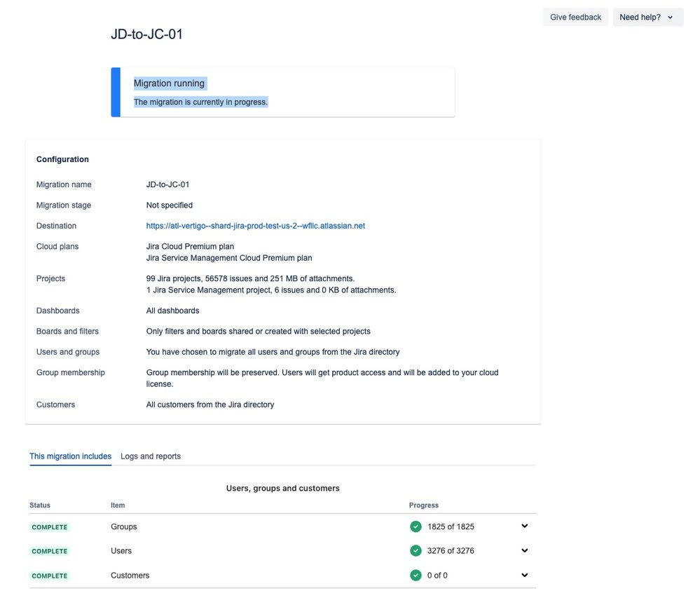

Same thing happened to me.
The Cloud Migration Simulation does not run properly for me.
