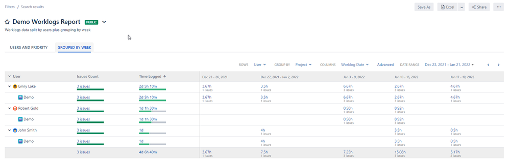

It does depend on what you mean by that. Basically there are two options to report by a time period:
1. Create a time related search, e.g. all issues modified within certain date range, like
issuekey IN updatedBy(jsmith, "2018/06/01", "2018/08/31") Then build the report based on search results.
2. If you use time tracking (Jira default or Tempo), you can create reports based on worklogs for a specific range. Here's an example of a report with worklogs grouped by week:
Hope that answers your question. If not, please let me know.

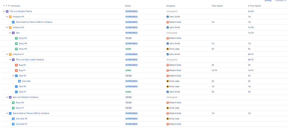

As an alternative solution, to visualize your Epic hierarchies and track sum up at each level, you can try out our add-on Agile Tools.
The app shows time spent summed up at Epic level.
Agile Tools - Epic Tree, Links Tree and Time in Status
Key features of the app are :
1) Links/Portfolio/Advanced Roadmaps Hierarchy :- View/Manage roll up for hierarchy (up to 10 levels), based on your Portfolio/Advanced Roadmaps/Issue Links parent child relationship.
2) Epic Hierarchy :- View/Manage roll up for standard Jira hierarchy. Epic -> User Story -> Subtask
3) Time in Status :- More than 7 types of Time in Status reports to track your issues.
4) Worklogs Report :- Track time spent by resources with multiple filters / category / grouping features
5) Timesheet :- View/Enter your time spent for multiple days
Rahul
Epic Hierarchy on Issue Screen as below
