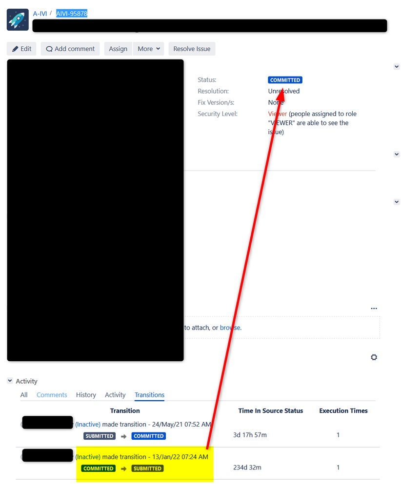

Missing ABC transition in Test-1 (Ticket)  on 01.09.2022.
In history you can find the entry but not in transitions
Could you explain more about what the problem is here? I can't see anything wrong with your screenshots of limited bits of the issue.
So the issue is not Closed?

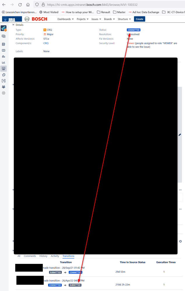

Ok, that looks like a bug in the transitions display - it's reporting a transition that did not complete (as the status is still committed)
This needs to go to Atlassian for investigation - work through a support request at https://support.atlassian.com/contact (or, if you're on a free or starter licence, tell us here, because you won't be able to raise one)

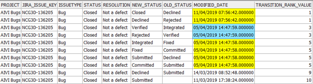

We get multiple transitions with the same timestamp. Those cannot be sorted without the knowledge about the transition sequence. I do not want to have such dependencies for all the clients using the data. This issue is from 2012 :-( and still not solved
In the list of transitions, it's not hard to work out the pattern, despite the missing milliseconds - the issues have been transitioned in pairs. Where you see
| New Status | Old Status |
| Verified | Integrated |
| Rejected | Verified |
The issue has gone Integrated -> Verified -> Rejected. It's the same pattern in the rest of your data.
