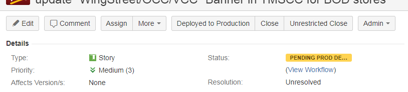

Here's a normal story in the same status as the broken one:
