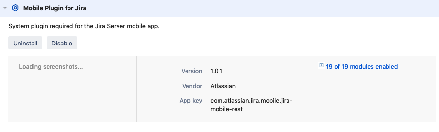

We have "Jira Mobile" v3.2.5, but the plugin in the bundled (/WEB-INF/atlassian-bundled...) looks to be v1.0.1 of "Mobile plugin for Jira". This one has modules named similarly to the plugins mentioned in the KB.
I tried re-installing the plugin from the app folder and disabling the "Jira Mobile" plugin, but none of this worked.

Those versions look to be correct for a Jira 8.3.2. I am interested to learn if perhaps one of these plugins might be disabled within Jira. If that happens, it could cause this error. Try going to in the UPM in Jira; Cog icon -> Manage Apps -> Manage apps -> select System form the drop down and search for the term mobile you should then be able to expand both plugins to see all the modules enabled for each, like this:
I suspect that in your system if one of the modules is disabled, you won't see the same '39 or 39 modules enabled'. But you can then click into that link in order to try to re-enable the module that might be disabled.

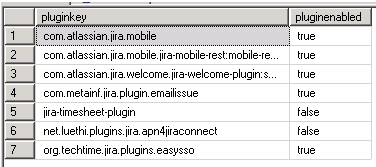

Alternative, you can try to run the following SQL command against your database to see if perhaps one or more module/plugin has been flagged to be disabled in the database:
select * from pluginstate;
This will return a list of all plugins that have been disabled in your Jira site. You could remove the entry from that table in the database and then restart Jira to see if that might help to make sure it's enabled again. If you're not sure which values should appear there, feel free to share the results you have either in the UPM or via the SQL query.

Thanks for the feedback. I did indeed check the modules, and all 19+39 were enabled:
Running the SQL query, they also seem to be enabled:
