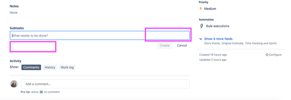

Kate Garbarino July 2, 2020
When you are on a story and click the Create SubTask button, the dialog box opens above the comments section.  We would like to add the Assigned To field either next to or below the Summary field.
Sachin
July 2, 2020
Thank you for the screenshot @Kate Garbarino , I think I now understand about "The quick-add buttons" which are considered a key part of the consistency of the new issue view—they're always there, right under the issue summary. According to New Jira Issue view and what @John Funk mentioned looks like this is all part of new jira issue view! Unfortunately there is no workaround at the moment, but you can add a comment on this ticket so someone might address this issue.
