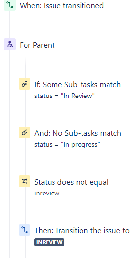

Hi @Jack Brickey ,
I have created the rules for below ,PFA images .
1. parent task goes into inprogress when the first subtask is in progress.
2.parent task into review when the last subtask is inreview , remaining subtask are already inreview or close
For 3rd condition :Parent task goes to "test "when the last subtask goes to "test", all the subtasks are already in "test" or "close"
What would be the condition ?
Appreciate your help
Anil
I think what you are looking for is the IF: Sub-tasks match Status = Test. I found the following post that does a good job of breaking down your requirements.
How-do-I-automatically-trigger-a-status-change-on-a-parent-issue
