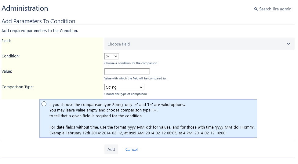

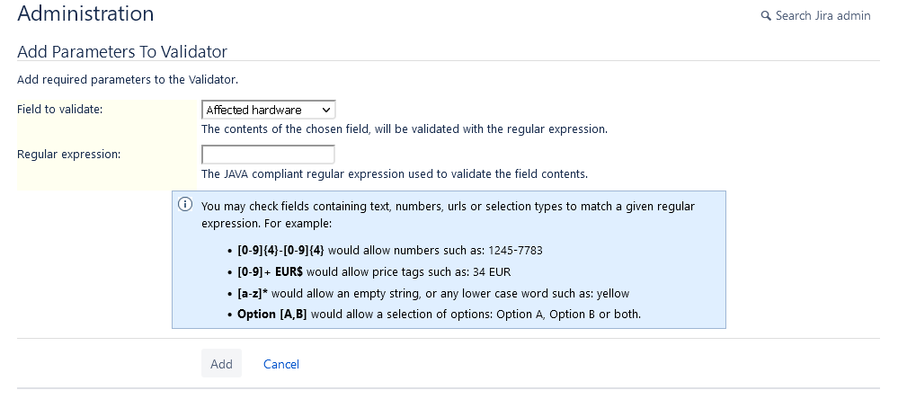

Hi @Idan Naamad
worth a try is the "Regular Expression Check" Validator:
It should not matter that the value is set in an earlier state - but the change to the 5th state should then only be possible if the value of the field matched your regular expression.
For conditions there is a "Value Field" condition.
This could be an alternative if you do not want to show the transition unless the criteria is met, like John explained.
