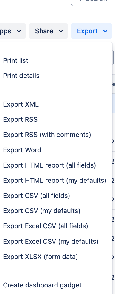

Export Issue:
- This is to take a backup of your entire instance and importing back to another instance or at time of data loss
- Export issues can be also used to export only issues based on JQL or filter
