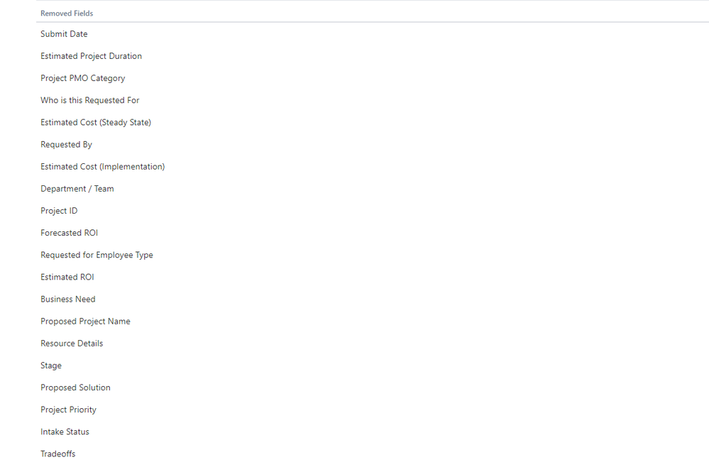

Thank you so much for responding and I am the system admin for my Jira Cloud instance and I created the same custom fields that were in my Team Managed Project within my Company Managed Project.  I did a test with one story moved it from the team managed to the company managed and I cand confirm that none of the custom fields copied over - I have attached a screenshot of the message I recieved before moving the one issue over.  The tool is stating that it is removing all of the custom fields - I am not sure what else to do.  One issue is that I have a huge number of team managed projects that want to convert over to company managed, these project also have huge number of issues associated with them.Screenshot 2023-01-03 143759.png

The data in the custom fields will be lost. It doesn't actually matter whether or not you have created matching custom fields in the destination project. The Move Issue process will not move the data itself.
The first part of the paragraph about needing to recreate the fields is not trying to imply that if you create them then the data will be moved. It is only saying that you need to recreate the custom fields if you want to have those same fields available.
