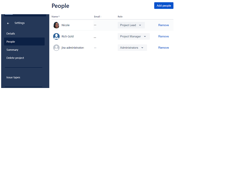

Query I'm attempting to write for this filter:
Roles page within project settings (I believe this is part of Tempo add-on):Screenshot - Roles.png

Within a project settings, there is a "people" screen where you can assign roles. I want to create a filter based on those role assignments.

Hi Rich,
You should be able to use any role, even if it is add-on created, this query worked for me:
project in projectsWhereUserHasRole("Administrators")
