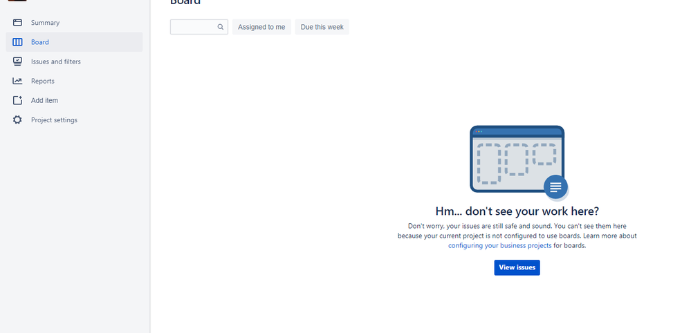

Hey guys, I'm having the same issue here.
For a Classic business project, the board simply dissapeared.
Workflow is associated, everything seems to be fine, but Board simple does not show.
Any idea on how to resolve, or at least troubleshoot this?

Thanks for your quick reply Jack! I was able to figure out what was happening.
Going onde more through some articles and documentation, I found out:
A board will fail if:
There is more than one transition between two statuses going in the same direction i.e. transition A and transition B both go from status C to status D.
With that in mind, I checked again the workflow and found that there were two transition from the same origin and destination status. The tricky it was that both transitions were with the same "points", so quickly looking at the workflow, I was not able to see that.
After removing the duplicated transition, board showed up again!
