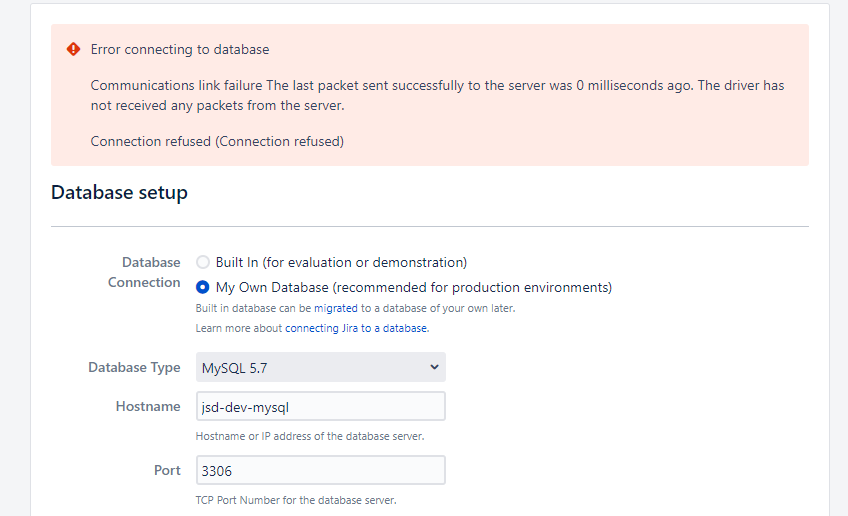

I am trying to configure MySQL on Jira setup but I am getting the below error, I have installed JDBC driver on JSD and restarted and everything looks good but still getting the error, please find the DB-2.PNG logs as well.
at java.lang.Thread.run(Thread.java:748)
Caused by: java.net.ConnectException: Connection refused (Connection refused)
at java.net.PlainSocketImpl.socketConnect(Native Method)
at java.net.AbstractPlainSocketImpl.doConnect(AbstractPlainSocketImpl.java:350)
at java.net.AbstractPlainSocketImpl.connectToAddress(AbstractPlainSocketImpl.java:206)
at java.net.AbstractPlainSocketImpl.connect(AbstractPlainSocketImpl.java:188)
at java.net.SocksSocketImpl.connect(SocksSocketImpl.java:392)
at com.mysql.jdbc.StandardSocketFactory.connect(StandardSocketFactory.java:211)
at com.mysql.jdbc.MysqlIO.<init>(MysqlIO.java:299)
... 176 more

Murugan Mittapalli September 27, 2020
Thanks, for your replies, we found the issue, i.e in one of the files configuration in DB so our DB team is able to resolve it.
Thank you once again.
Jason Galea
September 21, 2020 edited
Did you telnet the database server using the correct port?
if it doesn't, that might be the issue.
if not, make sure you set the jdbc driver in the correct directory and also check the permissions and ownership to match the other files from that same directory
cheers,
jason
Nic Brough -Adaptavist-
September 21, 2020
That really is what it says - the server tries to connect to the database server and gets back "no".  Could be a network issue, could be that the database server is configured to not listen to the server.  You'll need to debug those two problems.
