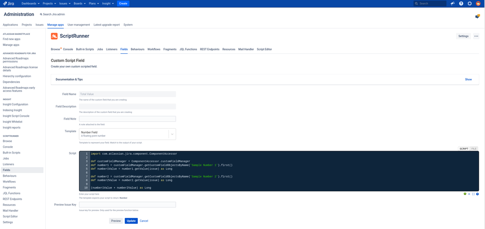

Below is a print screen on of the Scripted Field config:-

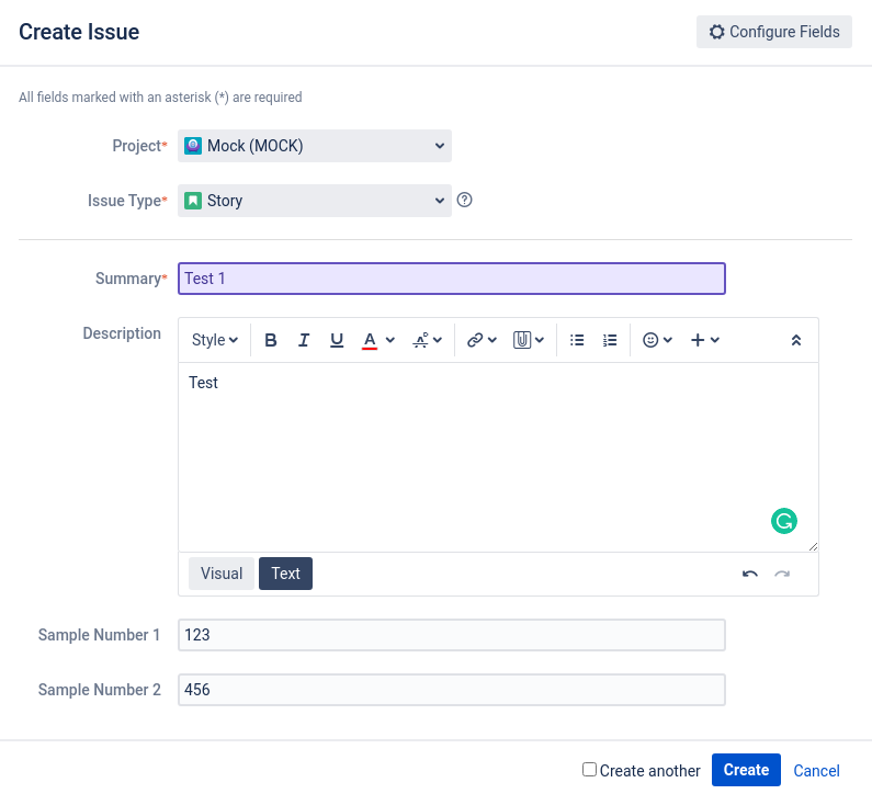

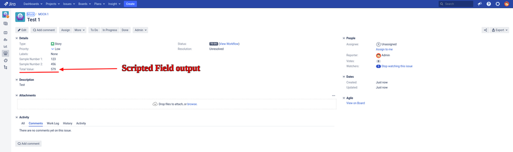

Below are a few test print screens for your reference:-
1. When the issue is being created, the Sample Number 1 and Sample Number 2 numeric fields are filled up.
2. Upon creating the ticket, the Scripted Field, Total Value is displayed with the total of the Sample Number 1 and Sample Number 2 fields.
