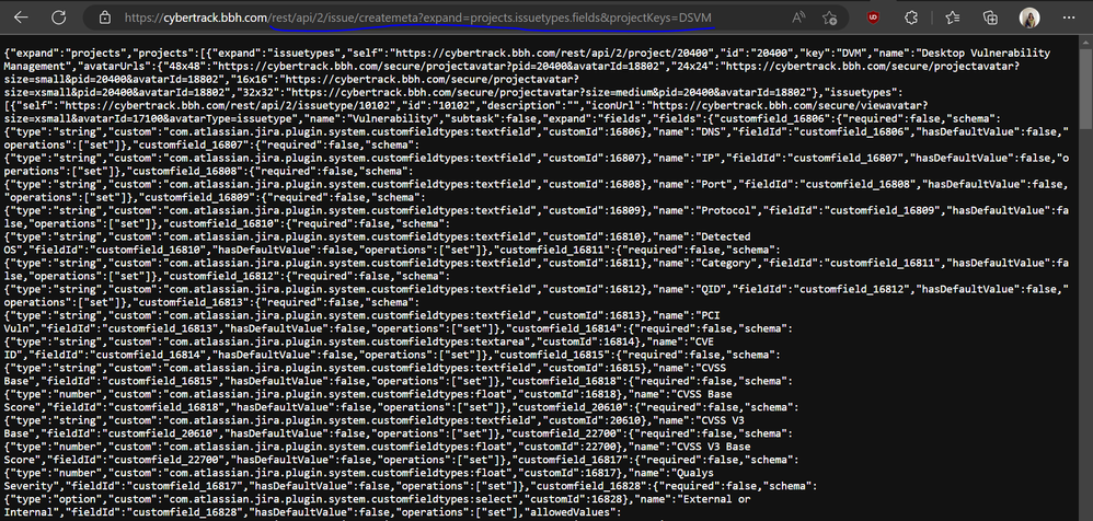

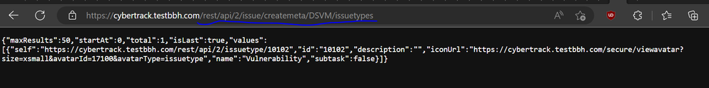

We are directly hitting the apis to the browser
In 9.4.0:
In 8.20.8:
If you can notice, in 9.4.0: we can't see the project in the response
Hi @Cyber BBH
If you notice, the urls for API call are different in both the screenshots.
Can you check again and let me know?
