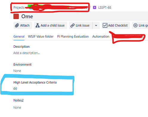

Hi @Kristian Walker _Adaptavist_
I already tried this, but it is not working. here are some of the screen shots.
In above case, it should be true.
Please advice.
Raju
Hi Raju,
I have tested this expression in my instance with a multi-line text custom field, and it works as expected.
Can you please save the actual validator and run this as I believe it will run as expected when the workflow transition is run as the issue you are seeing is just the test not recognising the field type correctly.
