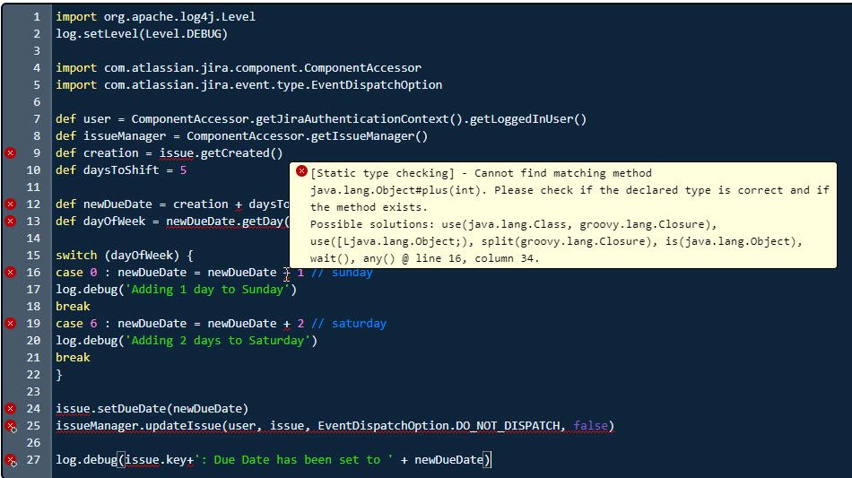

I created a transition in workflow as custom
I also got below error messages in console

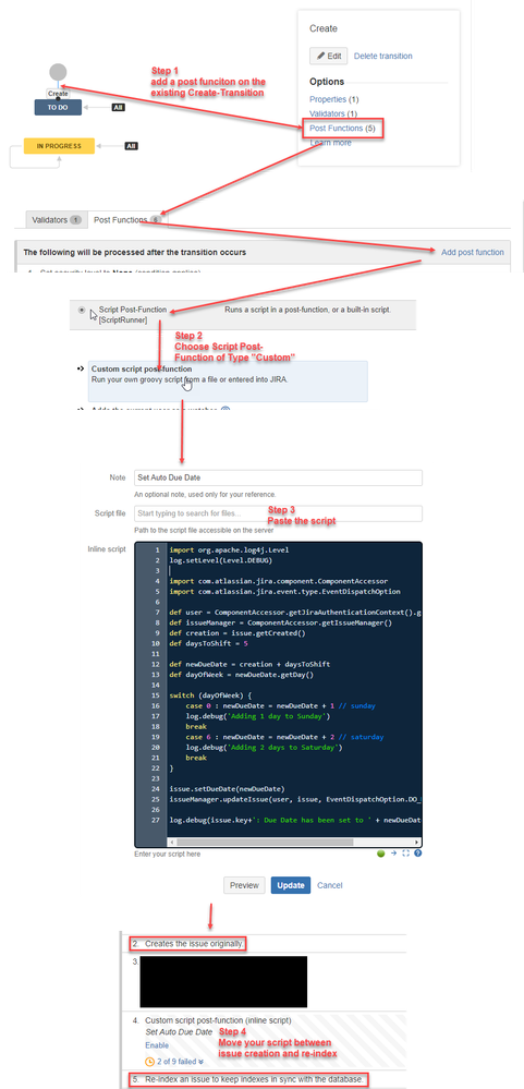

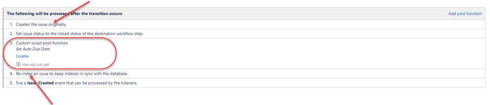

2) Do NOT create a new transition. This postfunction should run on the initial "Create"-Transition, which is the line from the circle to the first status. The script automatically sets the due date when an issue is created through this workflow.
Here are some screenshots pasted together to get it to work:
@Leonard Chew - Thanks a lot for your support, I was able to complete the steps. But I don't see Due Date getting filled in Automatically.
Is there any additional steps I need to complete.
@Vijaya Kumara Create an Issue (one that is created by this workflow). The script will be executed and you will see the logs (of the last 15 executions) in the screen you pasted above.
