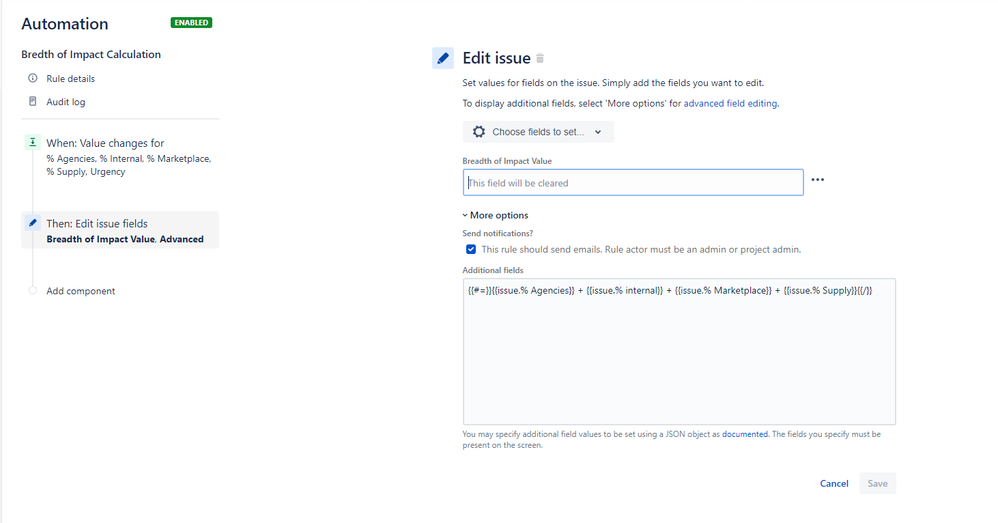

The Breadth of Impact calculation is fairly easy to do.

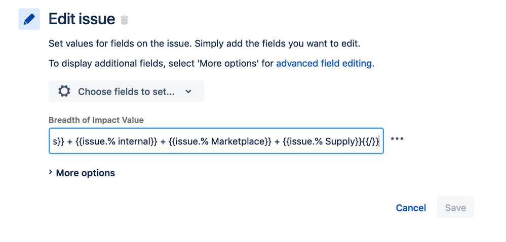

Create a new automation with the trigger of Field Value changed and set the fields to % Agencies, ect.
Use the Edit issue fields action and set the Breadth of Impact using the smart value as follows:
{{#=}}{{issue.% Agencies}} + {{issue.% internal}} + {{issue.% Marketplace}} + {{issue.% Supply}}{{/}}

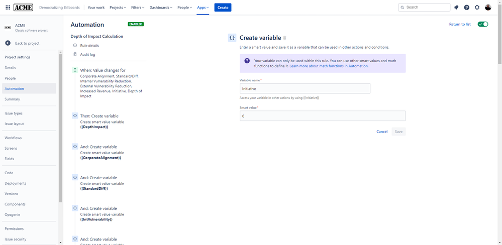

I am getting this error right out of the gate:
Error while parsing additional fields. Not valid JSON.
Put the smart value in the Breadth of Impact instead.

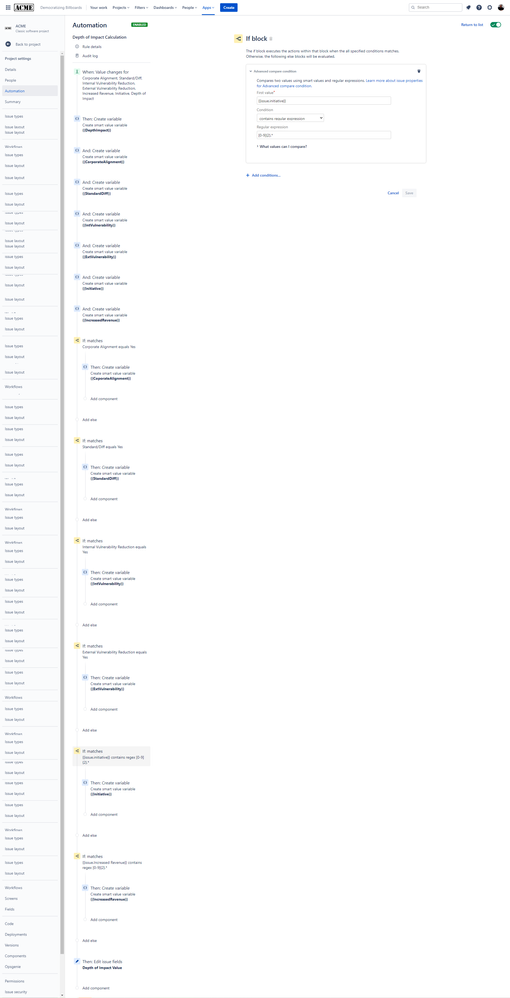

Getting the following error:

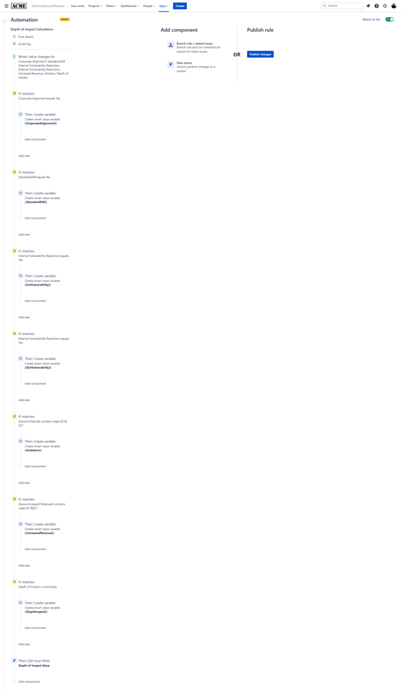

Here is how I have the rule layed out in case I have it wrong:

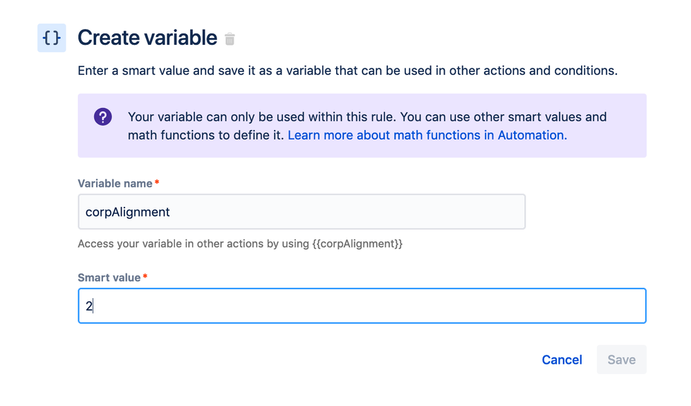

@Mark Ewart,
You missed the very first step. You first need to define the variables so that they'll be available when you perform your calculation at the very bottom. So first define all the variables you want to use, and then use the If/Else blocks to set the values if they are populated.
Does that make sense?
Thanks!
Kian
Are you sick of me yet!?
It does make sense.  Thank you!  Sorry for being such a newb!  :)
I fixed that error and now I am getting:

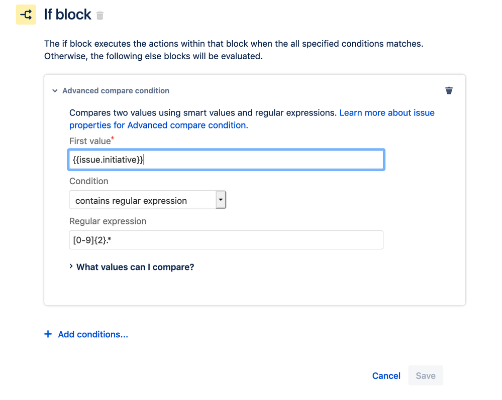

Error rendering smart-values when executing this rule:Unknown operator or function: ADKOM: 1 - ADKOM/Agencies + 0 + 1.5 + 2 + 0 + 0 + 0
@Mark Ewart,
I  don't see where Adcom/Agencies is coming from. Can you tell me please? Is that the initative the ticket is tied to?
Can you show how you defined the variables for that? It appears that its pulling the whole value. Given that it doesn't appear to have any numbers at the front,  it should not be setting that as the value.
What is your initial value set to for the Initiative variable?  It should be set to 0.

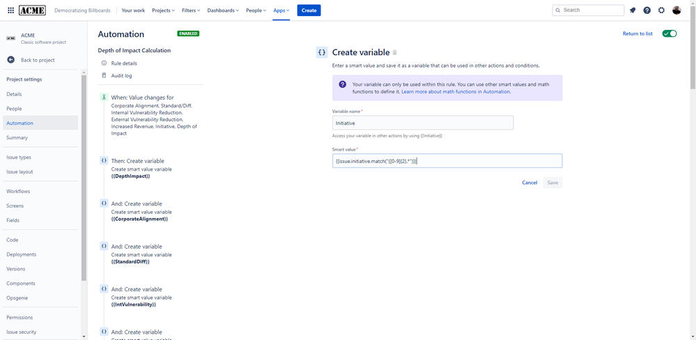

This is the Variable in the If Block:
The initial value is set to 0

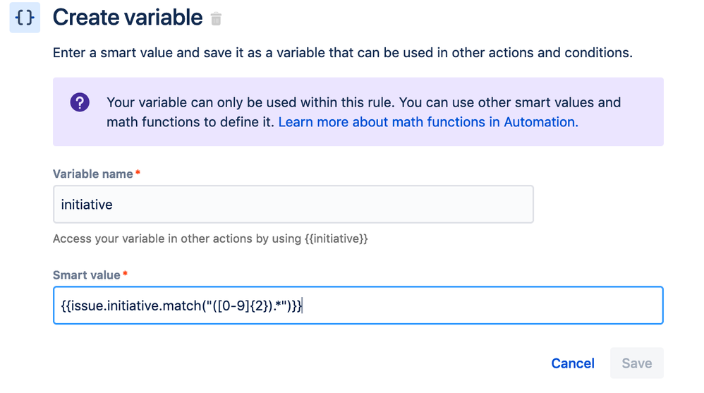

Your smart value setting is wrong.
Try this:
{{issue.initiative.match("([0-9]{2}).*")}}
I'm sorry that it isn't working. Keep playing around with it! I'm sure you'll be able to get it soon!
