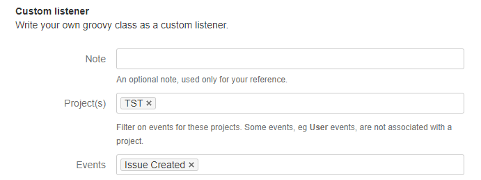

I would advise to create a Script Listener on the Create Issue event in appropriate projects. Make sure that this event is triggered in the workflows.Use this script (update the ids) :

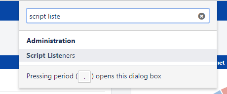

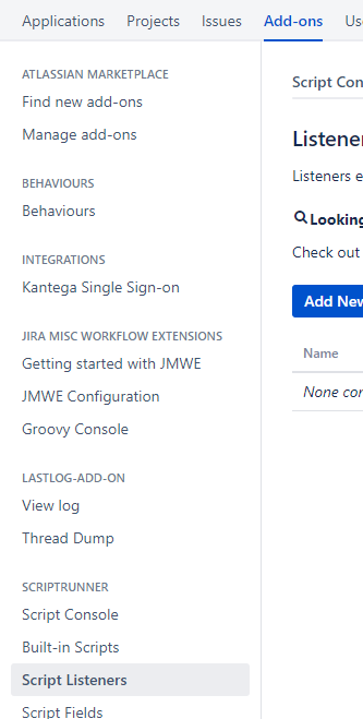

Hi, just type GG > script listeners :
You will end up here :
Antoine

You need to check the workflow transitions post functions. By default on creation the event "issue created" is triggered. Then in others transitions it is most likely a "Generic event", or "Issue Resolved" on resolution, and so on. You can replace them by existing or custom events if needed.
So, on issue creation, it will most likely trigger "issue created", on edition "Issue updated", and "generic event" if the user adds a value using a transition screen.

For the listener, just type G+G > Script listeners. Youh should only check transitions with an associated screen which contains the due date (otherwise the user cannot change it). Then, check which event is fired :
Once you have collected all the events which might cause an update of the due date field, create the script listener and link it to these events.
