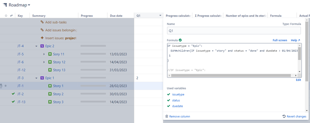

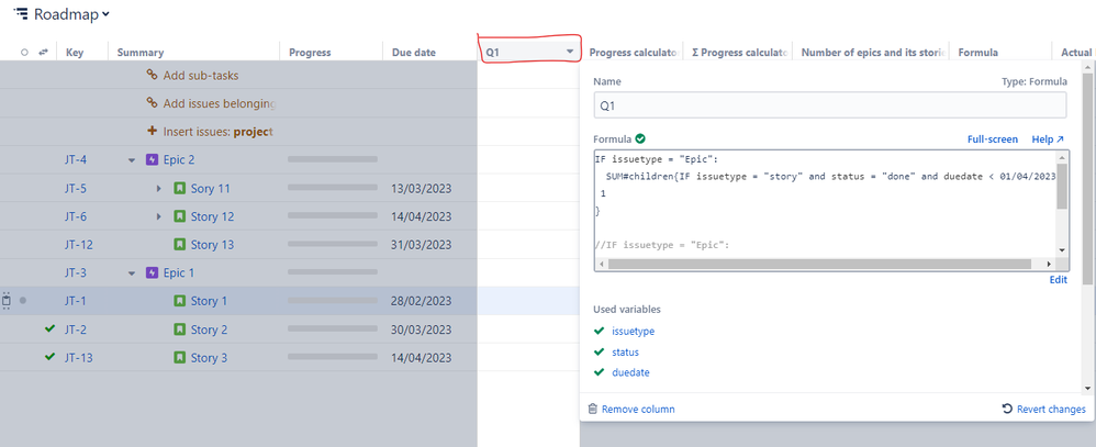

Thank you for the documentation@Valerie Knapp.
Here is what I have:
IF issuetype = "Epic":
SUM#children{IF issuetype = "story" and status = "done" and duedate < 01/04/2023:
1
The above I am using to show number of story completed whose due date on or before 31/Apr/2023.
SUM#children{IF issuetype = "story" and due_date < 01/04/2023:
1
This is used to show total number of story under epic whose due date on or before 31/Apr/2023.
when adding due date to the formula it doesn't show any data.
changing the due date from duedate < 01/04/2023 to duedate > 01/04/2023 shows under epic one. don't know how due date works with formulas and not sure how I can display the results 23/40 format or something like that.
