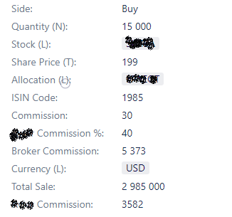

I am new to script runner and I am not a developer . I need some help to return a calculation , but it seems like something goes wrong somewhere.
When a number like 199 is input in the text field everything works and my custom fields returns values . As soon as I use a number like 199.50 the fields don't return anymore .

The following fields are text fields (the reason it is text is so that nrs are not rounded off) :
Share Price T
Broker Commission
And Last Commission is also a text field.

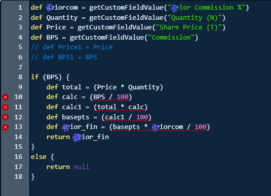

Good Morning Nic,
Thanks for responding.
I have removed the as bits as you suggested . I think I am now running into the problem that one can not do calculations on text fields ?

Nic Brough -Adaptavist-
March 7, 2022
Ok, so you have numbers in text fields, the trick there is that you'll need to read them out as numbers (you can't just wedge strings into number fields, they need to be interpreted)
From memory, the easiest thing to do is use the parse functions in Java - assuming BPS is a string that contains a written number, try
def calc = ( Long.parseLong(BPS) / 100)

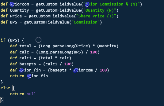

I entered the Long.parseLong before all the text fields . It works when there are no , or . in the numeric values in the text field. as soon as the price field has a . in it , it fails with this error :
Script field failed on issue: OV-42, field: *ior Commission (SF) java.lang.NumberFormatException: For input string: "200.50"
My edited script looks like this now as you advised :
March 8, 2022
I am really sorry, I've told you some total junk there!
Well, the idea is right, but I've picked the wrong method.  Longs are integers, they can't handle decimals.
So, I'm sorry to have to make you re-do a load of edits, but try:
def calc = ( Double.parseDouble(BPS) / 100)

Chris Scheepers
March 8, 2022
@Nic Brough -Adaptavist-
You are a Legend .
Thank you so much.
That did the trick !!!!
