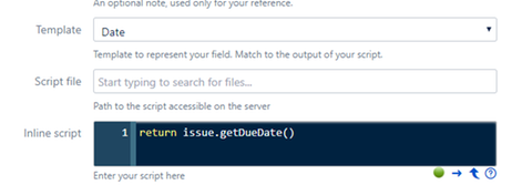

Hi @Aisha M ,
My advice would to be to create a "Script Field" (gg > Script Fields) with this configuration image.png
with a Date Time Range picker searcher :

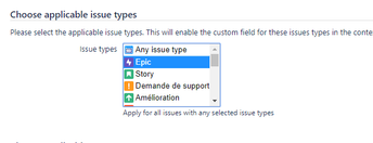

and make sure to edit the context so it is only available for epics :
Lastly add the field to the relevant screens, and voila !
This way the field will be synchronized with the due date in real time.
