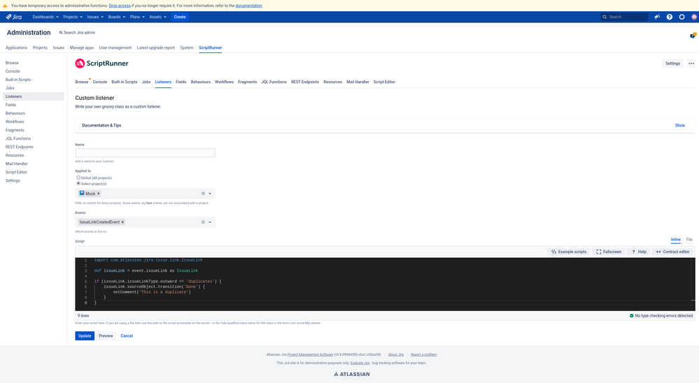

For your requirement, I suggest trying something like this:-
import com.atlassian.jira.issue.link.IssueLink
def issueLink = event.issueLink as IssueLink
if (issueLink.issueLinkType.outward == 'duplicates') {
    issueLink.sourceObject.transition('Done') {
        setComment('This is a duplicate')
Please note that the sample working code above is not 100% exact to your environment. Hence, you will need to make the required modifications.
Below is a screenshot of the Listener configuration:-
This code automatically transitions the issue that has been linked as a duplicate to the Done status.
Once you have created the issue, link it to the duplicate Link Type, and it will automatically transition to done status.
I hope this helps to answer your question. :-)

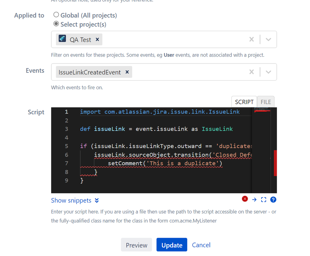

Garden16_ December 11, 2023
Getting static checking error .
The transition to close defect is the last transition. The issue link may be used at any different statuses. Is a transition required to close defect from all statuses
ERROR [runner.AbstractScriptListener]: *************************************************************************************
ERROR [runner.AbstractScriptListener]: Script function failed on event: com.atlassian.jira.event.issue.link.IssueLinkCreatedEvent, file: null
groovy.lang.MissingMethodException: No signature of method: com.atlassian.jira.issue.IssueImpl.transition() is applicable for argument types: (String, Script214$_run_closure1) values: [Closed Defect, Script214$_run_closure1@1aacbead]
at Script214.run(Script214.groovy:6)
