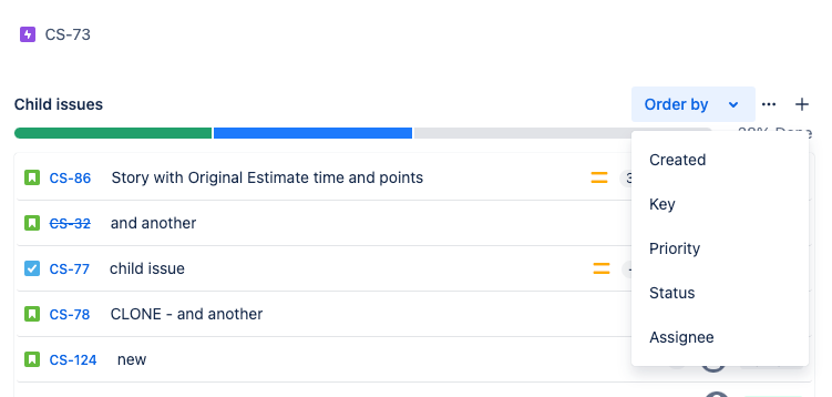

1. The sort order is not random. You can elect how you want them sorted by clicking on the Order By option above the Child Issues list. If you don't select anything then they are sorted by Rank.

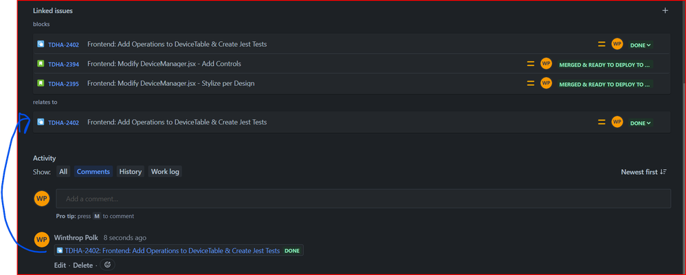

  2. Isolated issue: See screenshots. I can confirm that anytime a user enters a comment with a ticket number in it, it gets added as related even if already added as a blocker.
    • Can you please confirm this is NOT default operation?
    • Assuming the previous is true, can you please tell me where I should tell the Admin to go to look to fix locate and repair the custom automation? turnover is high and the Admin is not necessarily a jira SME.
image.png.
image.pngasdfasdf

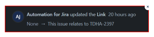

2.1 I can confirm that what you are experiencing is not built in/default functionality of the Jira Software product.
2.2
The history screen image you provide is a clear indication that the link was added by Automation because it says the responsible party is Automation for Jira.

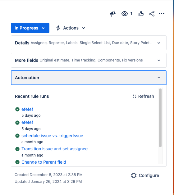

In either that issue or the other issue to which it is linked you should see a reference to the rule that was run.
Viewing the details of the issue look at the panels on the right. Below Details and More Fields is one labeled Automation. Expand that one and click the refresh button in it.
That will show you a list of rules run against that issue recently. The rule title can be clicked to go directly to the rule details, if you have sufficient permissions.
