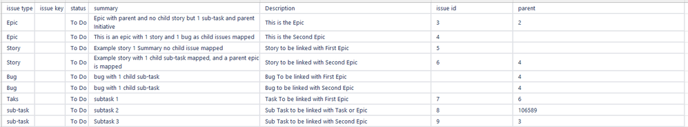

I have a requirement ,some example given below
I have to create a new epic ,Bug Tasks and Sub Tasks newly and link them each other properly
I would need a working template ,in the above what is the change i would need to do in csv file and the setting to be done in JIRA to do this import properly .Aim is to create everything one by one and link them properly .

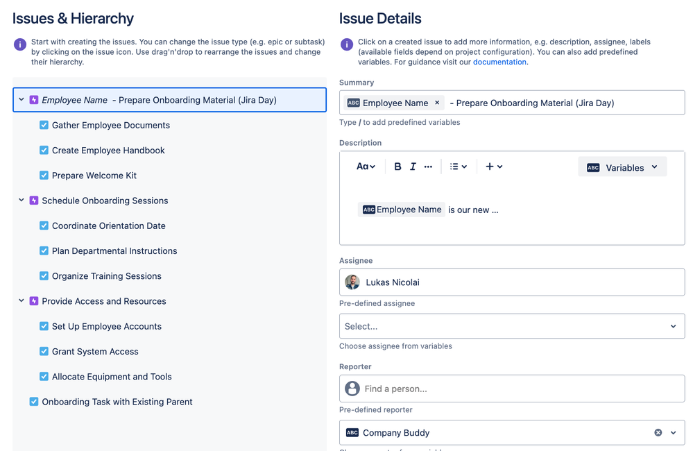

Hi @Marx ☺️, If you're open to using a third-party app for your cloud instance, I think Templating.app could be a good alternative to an CSV import.
You can easily create issue templates for hierarchies epic, issue, subtask. You can also link them with each other and afterwards you can create all of them in a project with just one click:
You can find us at the Atlassian Marketplace ➡️ https://marketplace.atlassian.com/apps/1224664
This is how such a issue hierarchy could look like:

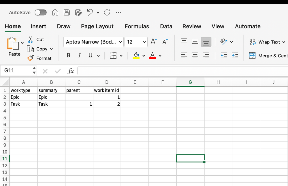

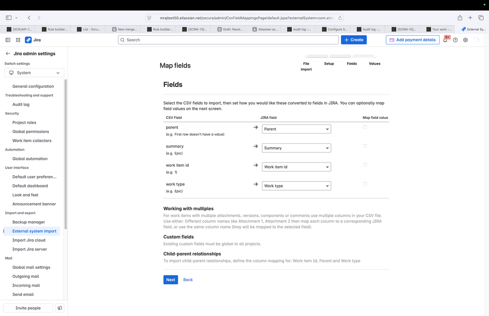

Hello, Good day. Please use the following format.
Screenshot 2025-05-22 at 7.54.05 PM.pngScreenshot 2025-05-22 at 7.55.07 PM.png
Mohanraj Thangamuthu
May 22, 2025
Confirmed on my test instance.

Thanks. Please create a Test Epic and a child issue under the Epic. After that export both these two issues to .CSV. You will get the format that is required to import the issues as well. Let me know if these steps help.
