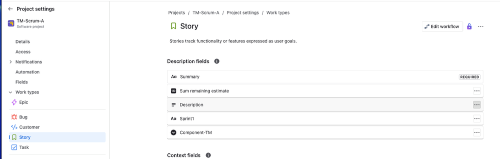

If it is a Team-managed project, you can set default text for the Description field by going to that project, then going to Project Settings, Work Types, and selecting the work type you want to affect.

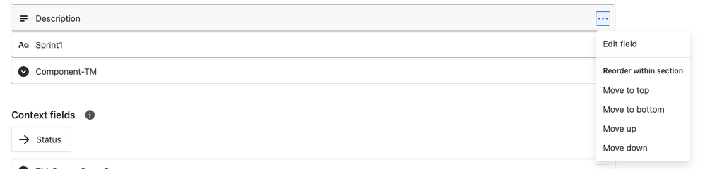

The click the ... button next to Description and select Edit Field.
You can then fill in the default text for that field.
