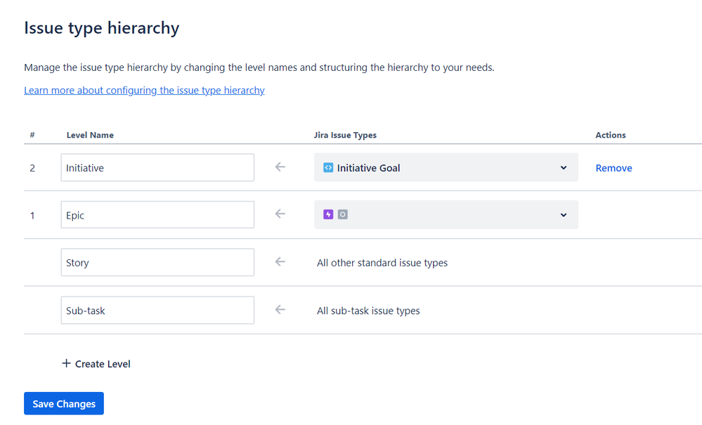

This doesn't match what you have shown in your Issue Type Hierarchy screen images, which is
Level 2: Groups
|-- Level 1: Workstream
|-- Level 0: available Standard issue types
|-- Level -1: "Action item"
You need to remove "Groups" from Level 2. That will automatically drop it back to Level 0 since it is a Standard issue type.

The Issue Type Hierarchy establishes the available parent/child relationships. For any given issue type, its parent must come from the issue types in the level directly above it and its children must come from the issue types directly below it. Based on the images you provided the parent/child relationships are:
Initiatives and Groups can be parents of Epics and Workstreams.
Epics and Workstreams can be parents of all other Standard issue types.
Those other Standard issue types can be parents of Sub-task issue types.
Conversely:
Sub-task issue type parents must be from the group of other Standard issue types
Other Standard issue types parents must be Epics or Workstreams.
Epic and Workstream parents must be Initiatives or Groups.
As I said, the Groups/Workstream relationship you have configured doesn't match your original statement about what you want. You need to remove Groups from Level 2 to fix that.

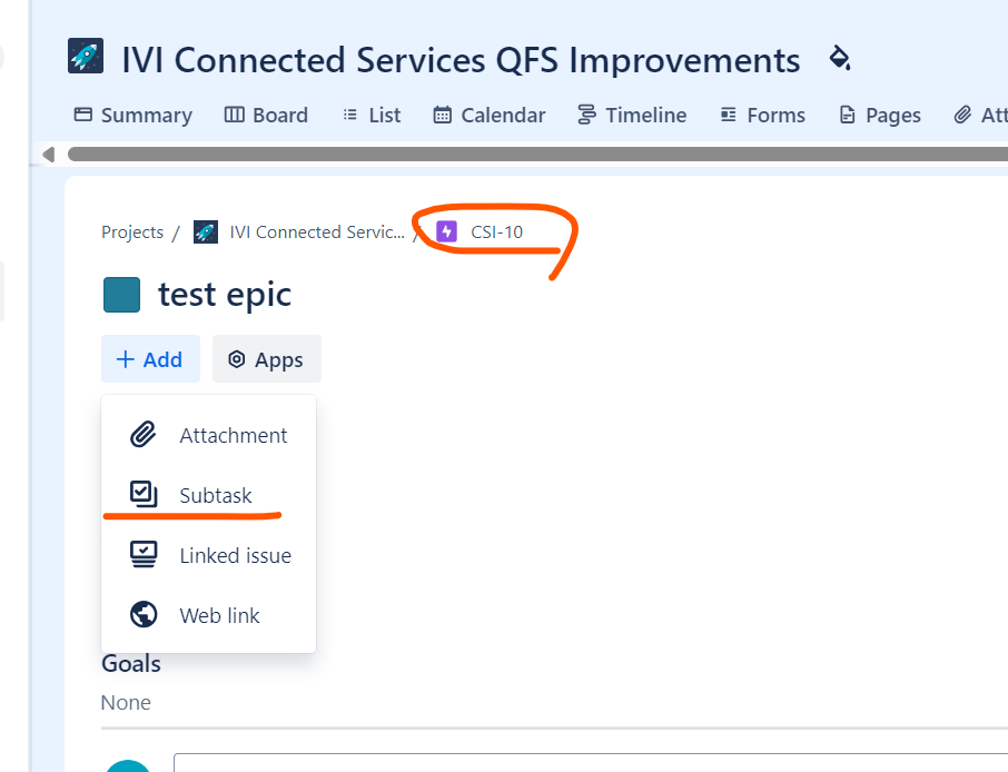

In the project when I want to create a new ticket I see the Issue type: Workstream which should be level 1 based on hierarchy, and Group which is level 0.
Then I have a workstream ticket, and want to open a Group under it, if I click on Add I see only subtask. am I missing a step?
Can you provide a new screen image of your Issue Type Hierarchy showing the issue types selected at Level 1 and Level 2?
I added a custom Standard issue type to my environment and then selected it at Level 1. In a Business/Work Management project I created an issue of that type. When I click on the +Add button I see an option for Child Issue, not Subtasks.
I thought maybe there is something wrong with my custom issue type, so I have added "Epic" into my project. Also epic is working as level 0 issue type.
Sure, I didn't delete the standard ones, epic and initiative, I have only kept Workstream as level 1. The grey circle icon is the workstream.
My company based project is a based on the Task management template, I guess this can be an issue, as I have now created a new project which is Cross team planning, and in this one I can see Epic, as Level 1 and under that I can add Childs.
