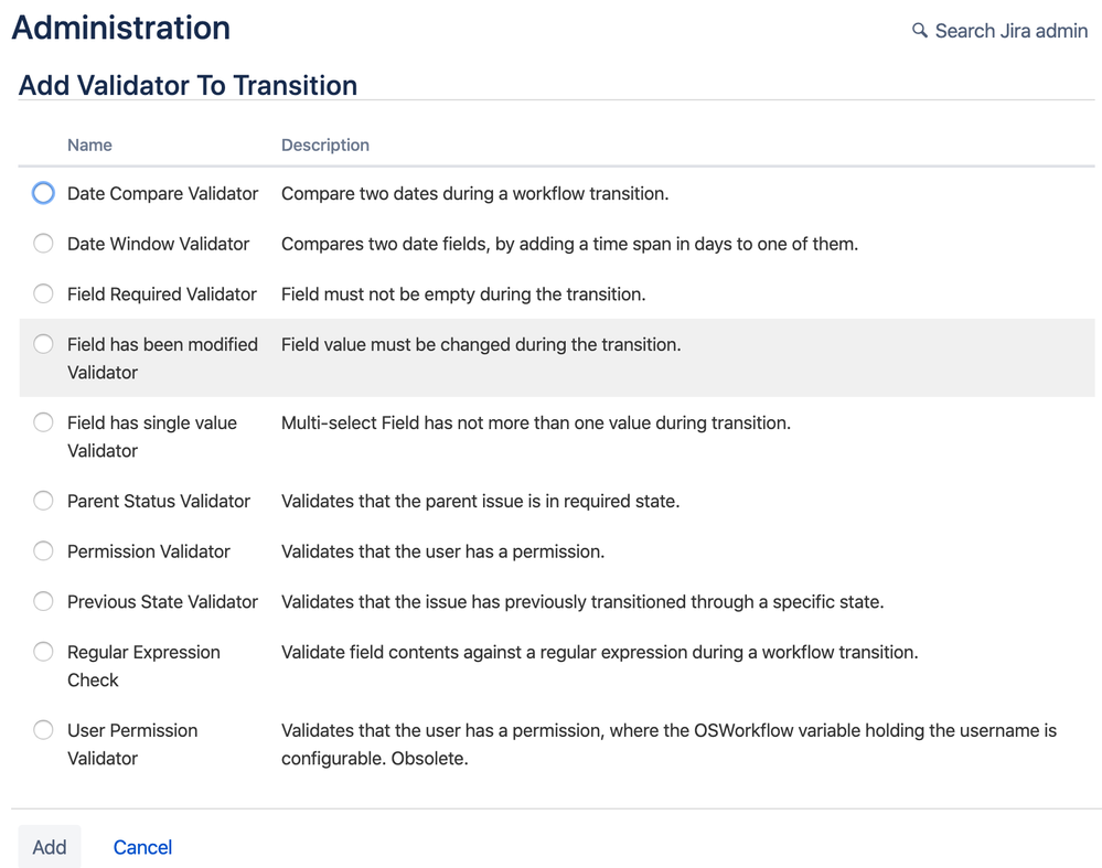

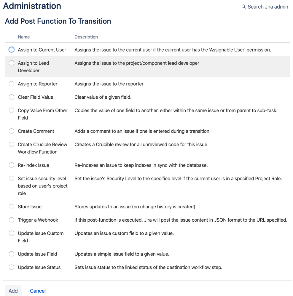

Every new issue will be created, I want to auto put "GA" in the Label field.
Looking at the Validators and Post Functions Options Listing (see two attached files)
There is no option that I can use. Any suggestion?

Hi @Hy - The best option would be to get an add-on like Jira Miscellaneous Workflow Extensions (JMWE) or Automation For Jira. Then it is very easy.
Without the add-on, you can probably accomplish it, but it is somewhat messy.
1. Create a new Custom Field and then use the Update Issue Custom Field post function to put GA in the new Custom Field since you cannot do that with Labels.
2. Create another post function and use the Copy Value From Another Field to copy the value from the new Custom Field to the Labels field.
That should work, but test it out if you do not want to acquire an add-on.
I hope this helps!
