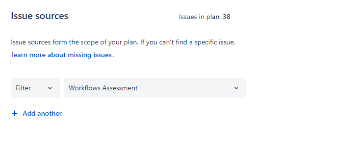

@Whitney Bell thank you for screenshots.
You need to edit your issue source (1st screenshot)
Choose Board instead of Filter in first drop-down and choose Board name Workflows Development in next drop-down to it.

Yes they are the same source- here is a screenshot of the filter being used on the plan page:

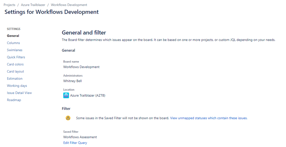

And here is that same filter being used by the board:

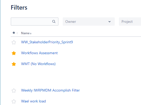

Also, here is the filters page where you can see there is only one by that name:
