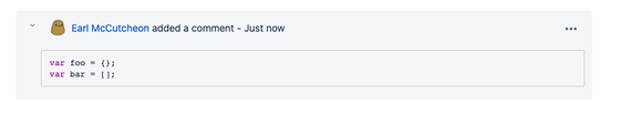

It will show up in the comment like this:

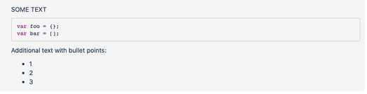

As an exe if you wanted to add in some additional text like the following screenshot:
Run a get on the issue and you will see the additional formatting as:
