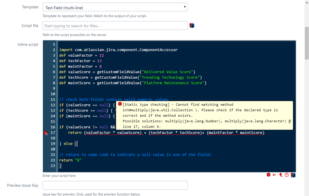

Approach 2:
I'm guessing this approach doesn't work because I'm using drop down values, however I'm not sure the correct way to adjust.
def valueFactor = 12
def techFactor = 13
def maintFactor = 8
def valueScore = getCustomFieldValue("Delivered Value Score")
def techScore = getCustomFieldValue("Trending Technology Score")
def maintScore = getCustomFieldValue("Platform Maintenance Score")
// check both fields contain valid numeric values
if (valueScore == null) { valueScore == 0 }
if (techScore == null) { techScore == 0 }
if (maintScore == null) { maintScore == 0 }
if (valueScore != null && techScore != null && maintScore != null ){
return (valueFactor * valueScore) + (techFactor * techScore)+ (maintFactor * maintScore)
} else {
// return to some code to indicate a null value in one of the fields
return "0"
Christina Hiller
June 12, 2019
Piecing together a bunch of other posts I figured it out. :-)   Here's what worked.  Doesn't handle defining null value as 0 like I wanted, but I can work around this and make the score fields required.
