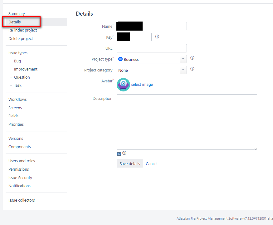

I am administrator and I don't see place where project lead can be changed.

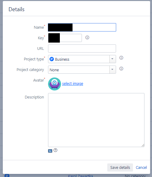

I tried from 3 places:
1. Project setting -> details
2. Project settings -> roles and users
3. System -> projects -> edit
I am full system administrator, please help.

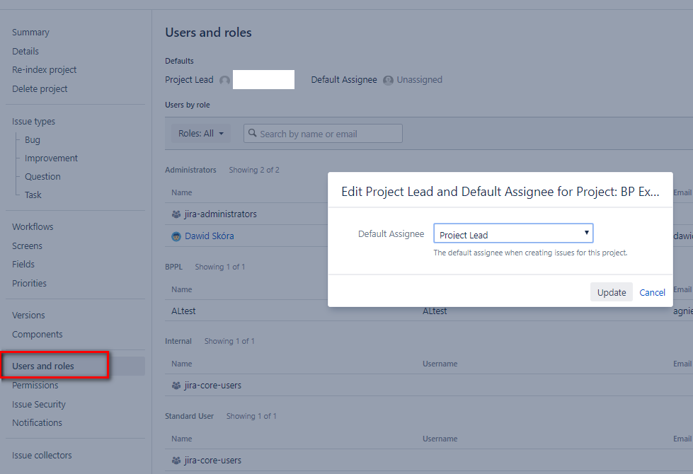

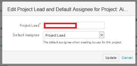

OK, so definitely the place where you change thee project lead is the first screenshot. You should go to your Project > Users and Roles > Edit defaults. That opens a popup and show two fields - Project Lead (which is required field) and Default Assignee. The title of the popup also confirm that "Edit Project Lead and Default Assignee for Project... "
Lets focus then on that screen and try to answer why you do not see the Project Lead field..

look at the Users and Roles page - on the top right side, there's a function: Edit Defaults - that's what you are searching for
Dawid Skóra October 17, 2018
Hi @Thomas Schlegel
I have attached first screen from this place, I have only option to change Default Assignee but not Project Lead :(

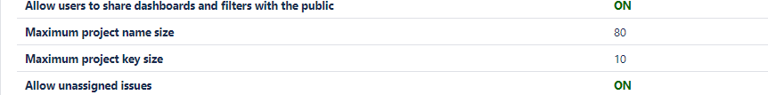

Is your project name longer than 20 characters? Then you might have this problem:
https://confluence.atlassian.com/jirakb/project-lead-cannot-be-altered-for-a-specific-project-for-jira-7-802162379.html
