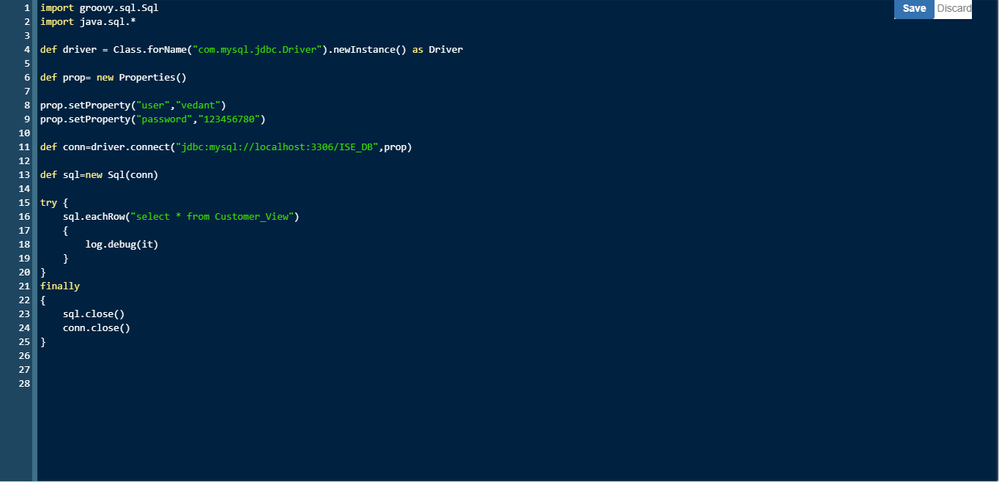

as shown in screenshot I imported the required package.

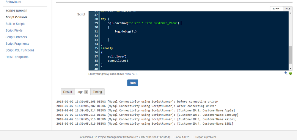

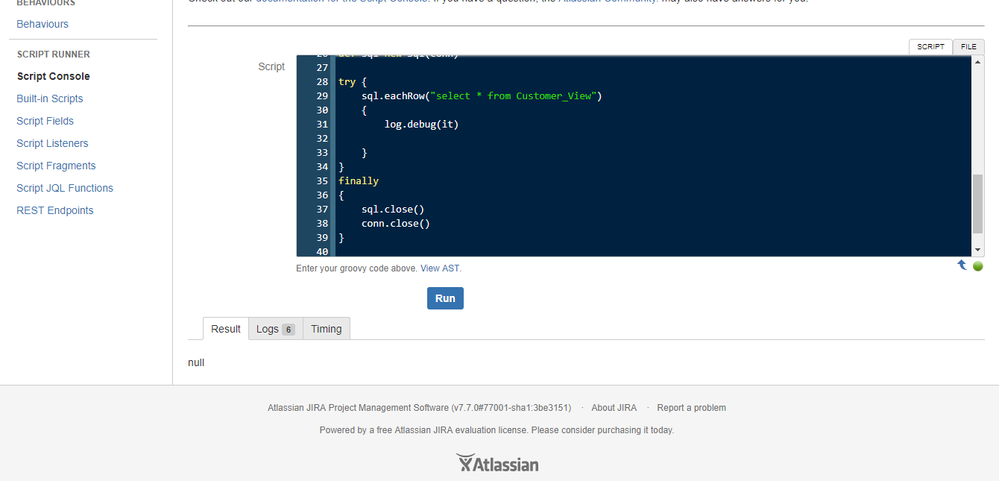

Yes, the script is running on console with desired output but it's not running when I tried to run through behaviors
in the logs, I am getting output but in the result tab, I am not getting output. Do I need to write any return statement? so that it will print
