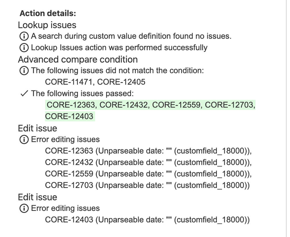

When trying to use the lookupIssues function to update my Epic with earliest Target start of the child tickets I am getting an (Unparseable date: "" (customfield_XXXX) error.
I followed all the instructions in the previous threads to use the lookup action and everything is successful except for the edit Epic part.
I tried using log action to see if it was a format issue with data stored in Target start but it always returns nothing for that field.

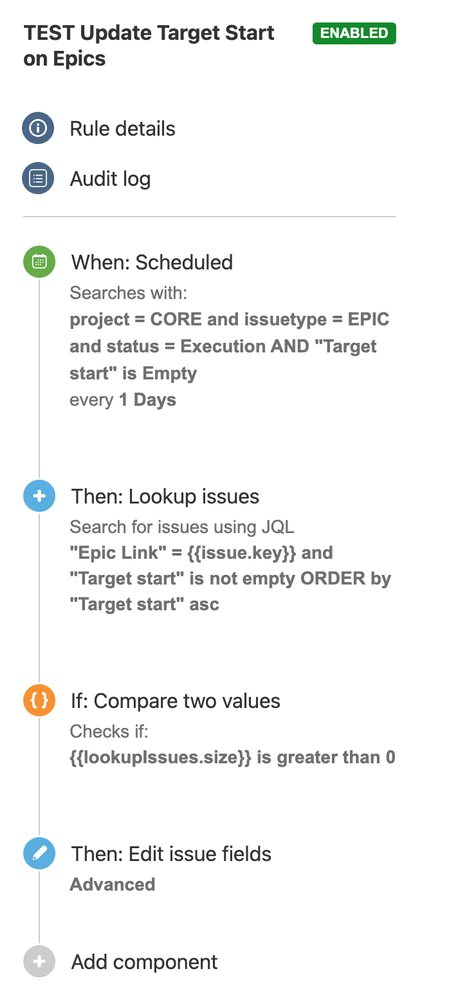

For a question like this, please post an image of your complete automation rule, images of any relevant actions / conditions / branches, an image of the audit log details showing the rule execution, and explain what is not working as expected. Those will provide context for the community to offer ideas. Thanks!

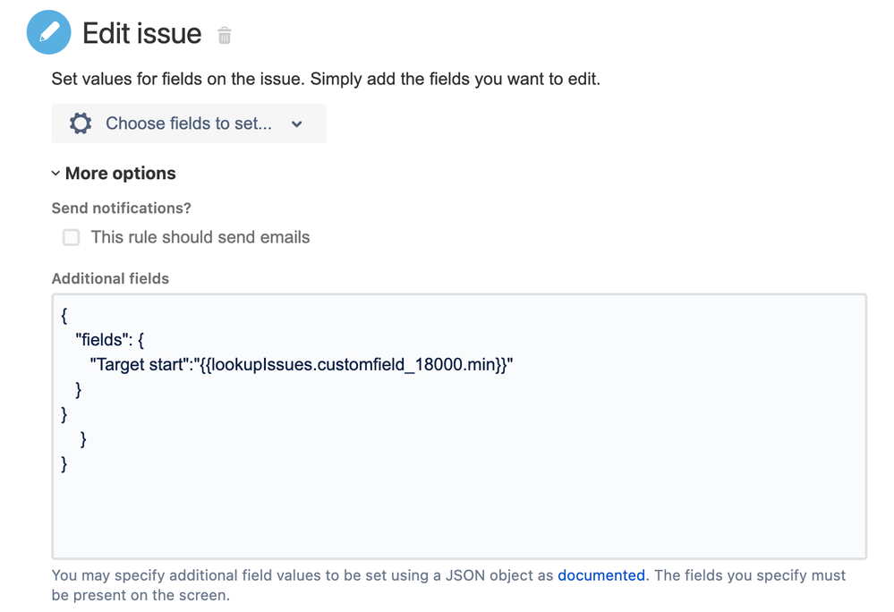

@Bill Sheboy Thank you for the reply. I will try to see if the workaround is available for me. I am adding the screenshots as requested just to make sure there isn't something I am missing. Also, I have tried every format from your suggestions in previous threads about this topic - Using "Target start", "custom field", jiraDate, toDate, format, etc - and still get the same error.
There are definitely some stray / extra curly brackets in that JSON. Perhaps remove those.
Next, smart values are name, spacing, and case-sensitive. And, smart values for a field in automation rules do not always match the displayed name on the Jira issue views. To confirm if a field is supported by rules, and what the smart value (and custom field id) are, please use this how-to article:
https://confluence.atlassian.com/automation/find-the-smart-value-for-a-field-993924665.html
This will tell you if the field is available, but not necessarily if Lookup Issues supports it. You can test that by writing the field from the lookup result to the audit log to determine if it is present or null.
One more thing...if the field is supported and present in lookup issues, the format to set a date field for JSON editing is "yyyy-MM-dd" and so remember to convert to that (after the min function) with jiraDate.
