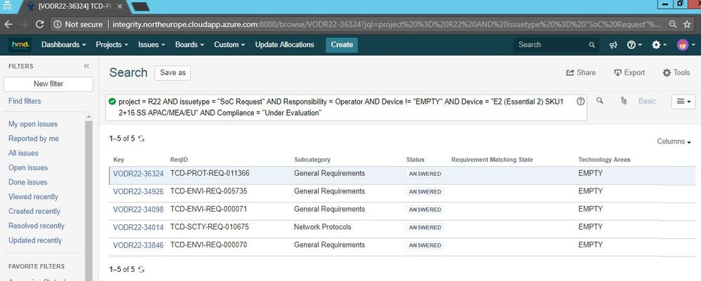

in most of the projects in our jira when i try to open i am able to view the issues in it but when i try to open/access it by clicking on issue key, it doesn't open up the issues, only in new tab we are able to open the issue.
any suggestions for this?

Thanks @Andy Heinzer for your response . I noticed one weird issue today.
I was reporting i was not able to click on the issues and access it. but the same issues are not accessible in detailed view itself . But from list view its visible properly but again for opening those issues i need to open in new window.
Attached Screenshots for refernce.
Any suggestion why this is happening?
And to answer your query regarding other browsers yes this is coming up in all the browsers.
