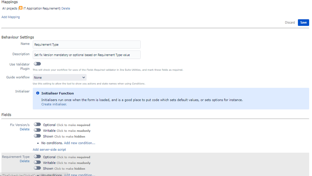

Hey @Manjupriya T ,
are you sure that you setup behaviour correctly with a correct mapping to your project/issue type and adding my code to Requirement Type field? Please could you share behaviour configuration screenshot?
Fabio

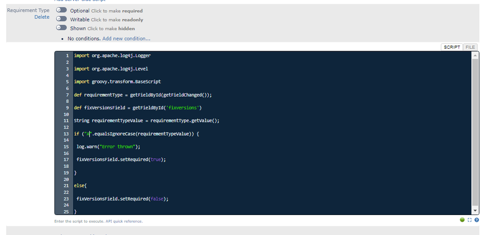

Manjupriya T June 15, 2023
Hi @Fabio Racobaldo _Herzum_ ,
I have the correct mappings and the script have been added to the correct field.
June 15, 2023
What field type is RequirementType?
It's Single select drop down type.
