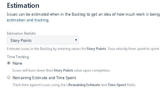

Not able to view the story pints on Sprint board, Bakclog screen, Also burndown chart shows zero pts, have verified the Estimation under Active Scrum board setting it seems correct (attached is the screenshot) also the fields screens screenshot is attached.
Please let me know if I should be looking at something else.

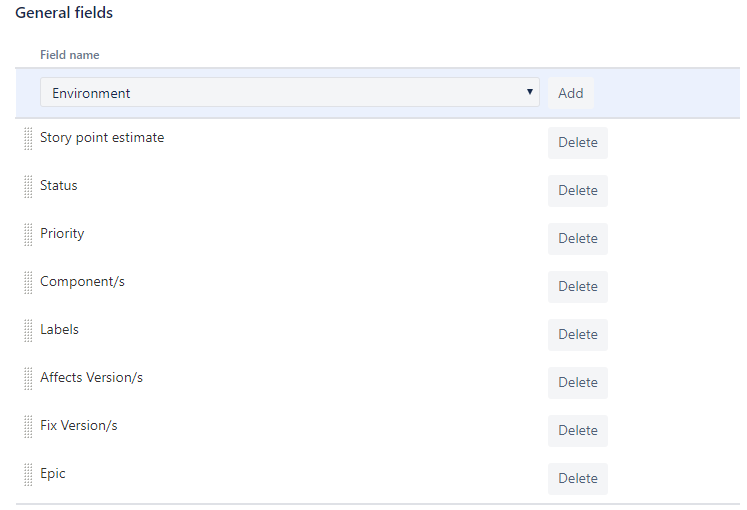

did you add the related column to your =>Board Configuration=>Issue Detail View?

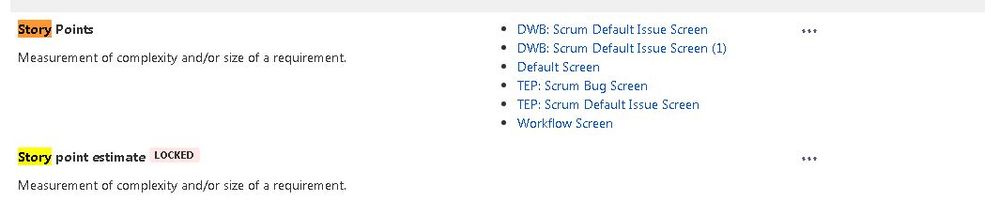

Seems you are mixing up two different custom fields. Since you selected "Story Points" for "Estimation Statistics" you should add it to the columns. But you have added the Story Point Estimate instead.
Cheers
Heiko
So should I delete it ?
I do not see the other one 'Story Points' on the list here.
