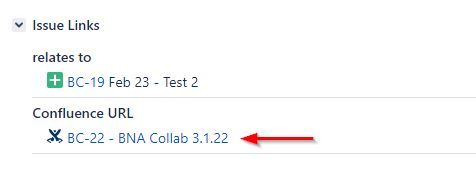

I have an automation that creates a confluence page when an issue is assigned and creates  a Confluence URL link to that page in the Jira issue links section. like below.
The problem I'm having.  I can't find a method to access the confluence url after it is created.  All of the methods for linked issues cant see the confluence URL.
Any help is appreciated

David Fischer
March 2, 2022
Links to a Confluence page are not issue links but remote links. They are not accessed the same way.
JMWE offers a "simplified API" for accessing the remote links of an issue:
issue.getRemoteLinks("APPNAME")
In your case, the APPNAM is likely to be "confluence", so:
issue.getRemoteLinks("confluence")
 Then, to get the first link's URL:
issue.getRemoteLinks("confluence")?.first().url
SJ
March 3, 2022
That works!
Thanks!  I've been working with Groovy for a week and this api for a few days so this is a big help!
