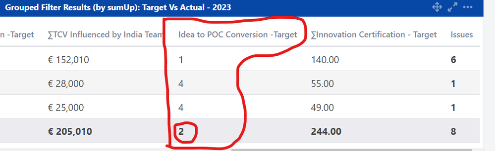

Hi Team,
I have added new gadget Grouped Filter Result(by sum up) and added filter.
But at the end Average of field is not coming correct.
As in the screenshot given- "idea to POC conversion - Target" is average field created through "Calculation Rule".
the sum up is 1+4+4= 9 and total issue are 8
so, at the end average should be 1.12 but here it is showing 2.

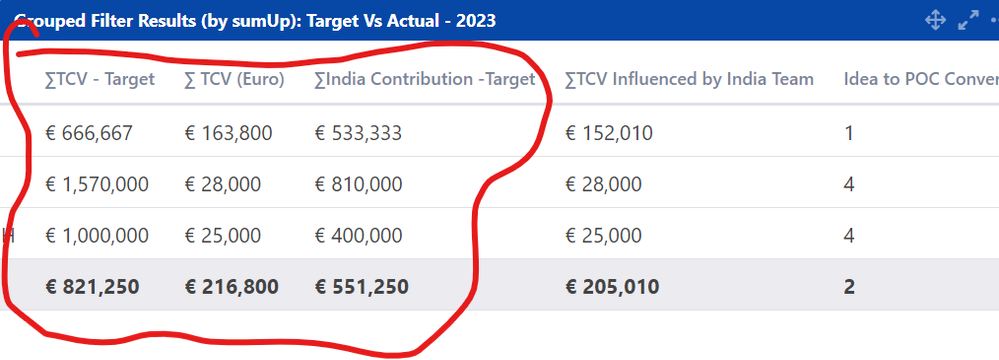

Similarly for TCV-target, TCV (Euro) and Indian Contribuation-target
Please guide on this.
Thank you!
