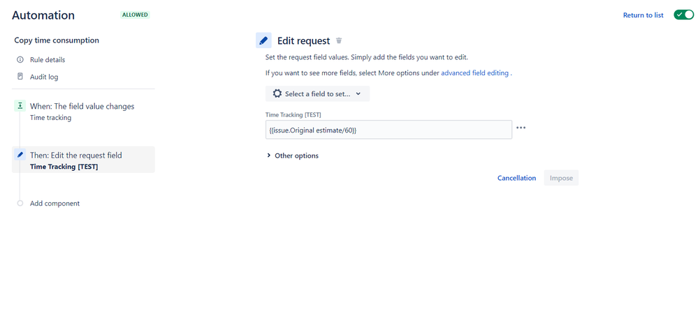

I am trying to use the automation to copy value from Timetracking original estimation to my custom field.

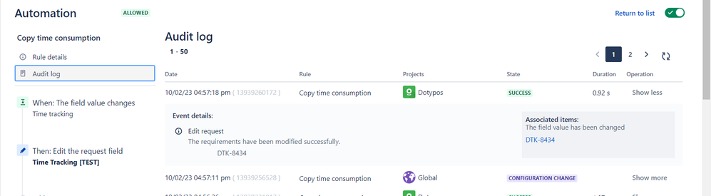

I receive a success in the Automation log, but the value is not copyied.
My custom automation formula is:
"fields": {
"customfield_10084": "{{timetracking.originalEstimate / 60000}}"
The part /60000 was added to transfer timetracking to minutes. But still, even if my custom field is number,
Thanks for the solution.

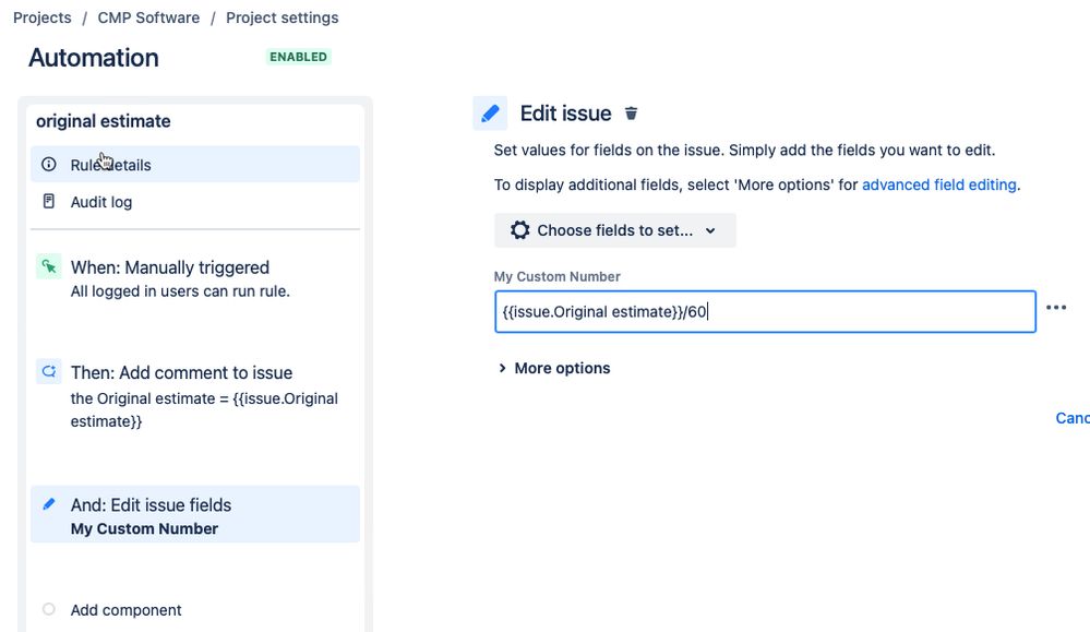

hi @Filip Novák , this quick test worked for me. Note, I used "60" to convert the OE from seconds to minutes.
Filip Novák February 10, 2023
@Jack Brickey Thank you, but it doesn't work still.
I do receive success, but the fields does not copy to each other.

I think the issue is with your malformed smart value. Move the"/60" outside of the braces.
{{issue.Original estimate}}/60
The only other difference that I see is that it appears you have a global rule while mine is project specific but that shouldn't matter.

Filip Novák February 13, 2023
@Jack Brickey It works. Thank you
