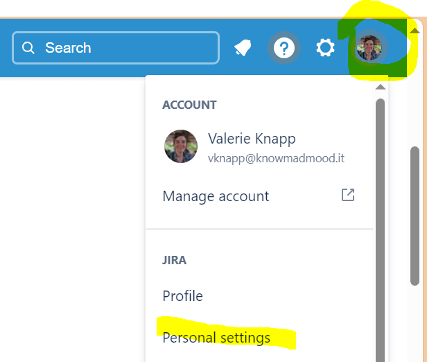

Hi @abhishek.s-j , welcome to the community and thanks for your question.
Please check, in Jira, your 'Personal settings', here
You might have all the email notifications switched off by default and would need to customize or switch back on the ones you want-
Please check these settings and let us know if this solves the issue.

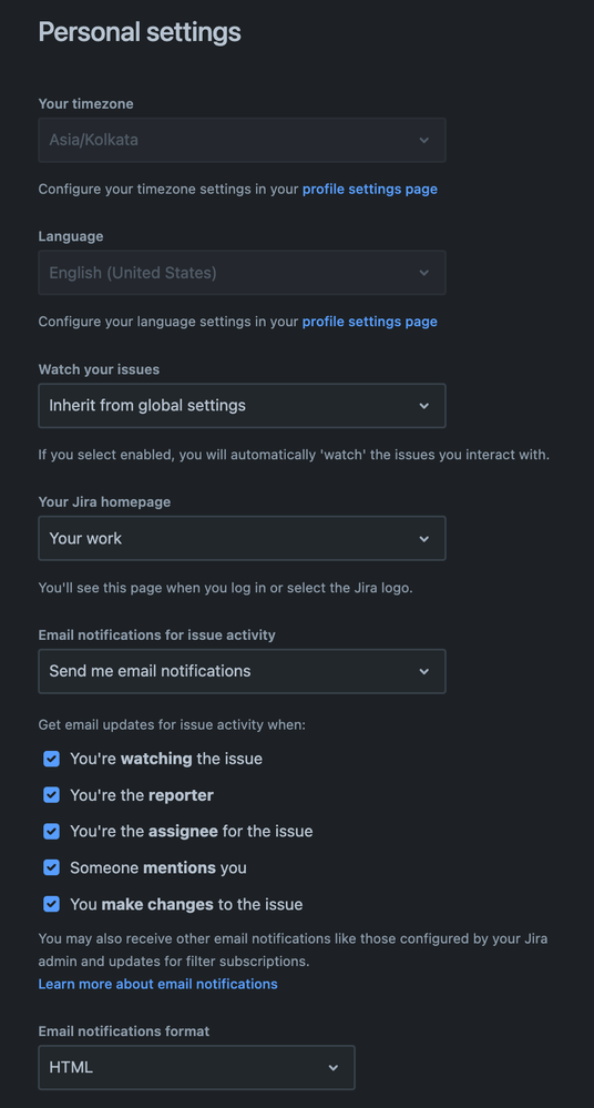

So here is my current settings, despite this I am not receiving email notifications from JIRA.
